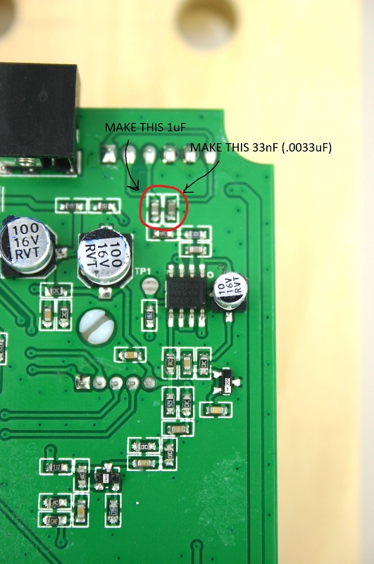

I FIGURED OUT THE DEPTH KNOB.
So, after posting the schem I drew up in a FB group, someone mentioned the "thing that needed to be fixed" (which has been alluded to a few times, but no one really knew what it was).
Apparently, the two caps that connect to the depth knob are backwards (left one is 33n, right one is 1u). If you take them off and switch them, it makes the knob turning VERY noticeable. :joy:
I don't have any SMD parts, so I just used a couple MLCC caps I had (the little yellow drop-like ones) because the caps decided to fly away almost immediately after I removed them :facepalm: .

Digitechrep already talked about that. Not backwards. Just a different kind of tone knob with them switched

Swapping the caps turns the Depth knob into another tone control. Which is completely superfluous on a pedal with a 3-band semi-parametric EQ. That is a MOD, not a fix, the stock Depth control is not broken.
p.s. this mod also (IMHO) adversely affects the distortion characteristic of the Boneshaker and also causes weird drops in gain and volume in strange places.
p.p.s. It also voids the warranty.

DRodriguez wrote:Digitechrep already talked about that. Not backwards. Just a different kind of tone knob with them switched
DigiTechRep wrote:That is a MOD, not a fix, the stock Depth control is not broken.
Yeah, I figured this out after I posted. :lol: :facepalm:
