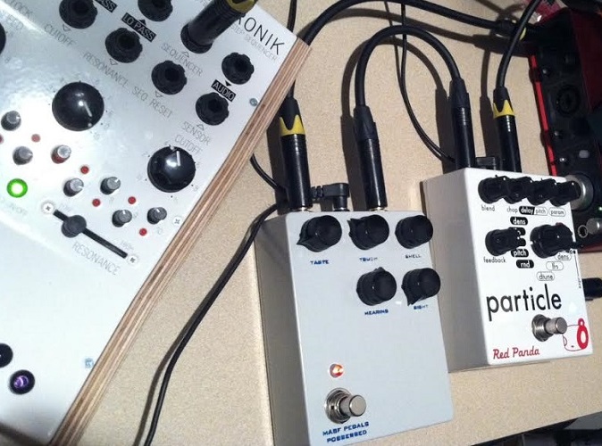

Hey hey, here was my attempt to emulate the Anti-Nautilus. It's granular chippity choppin is similar to the MASF possessed, but it also does reverse kinda like the Red Panda particle...so i ran the particle into the possessed. also took the sequencer CV of a Koma FT201 into the expression in on the particle to control the probability of direction, because of fun.

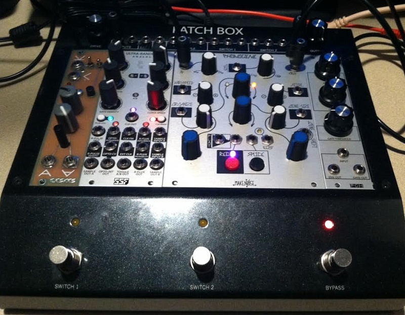

Re: UG demos Make Noise Phonogene
Hey hey, here is a listen to the Make Noise Phonogene in Broken Echo realtime mode. No modulation, just made a couple adjustments to slide and gene-size throughout.
:joy:

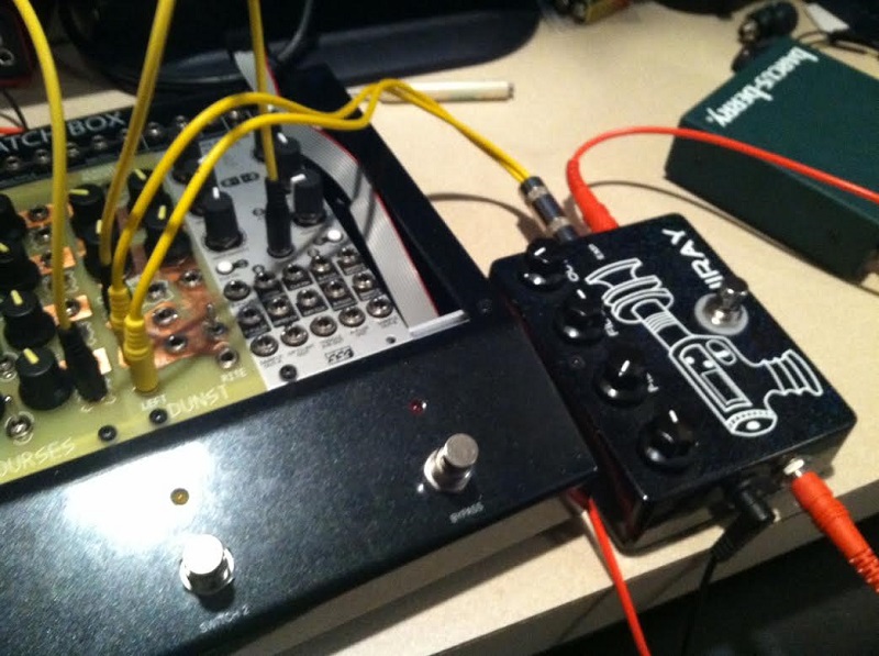

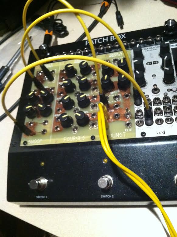

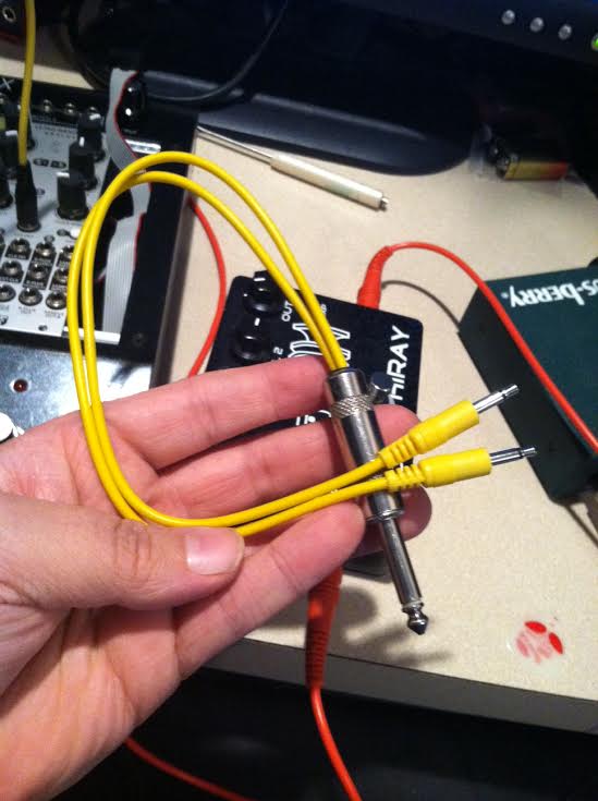

Hey hey, awhile back I read about a trick that would let you use CV from synth gear with pedals that let you use an expression pedal but not CV. You need a VCA, and a simple cable mod. Well, i just got a couple modules with VCA :joy: Don't really understand the WHY, but the how is you make a 1/4" jack to 3.55mm Y cable. Plug this into the pedals expression input, and plug the 3.55mm ends into the IN and OUT of the VCA. Then you modulate the VCA with whatever CV source you want, and like magic your pedal's parameter is being controlled. :cool:
I only had a chance to try it out with a Freakshow Effects Hiray gated fuzz, which has expression control over one of its filters. I tried it out with a couple different CV sources, and it worked! Here is a little clyp, its a pretty simple but clear example. I used the clock output from an ultra-random module. First is the pedal on its own, then I plug in the expression cable. i play a little line and then change the clock speed a couple times. The guitar is plugged into the Hiray and that is direct into the 2i2 interface.

Re: UG demos cable mod for using CV as expression input on p
Recorded a quick clyp of the Ieaskul F Mobenthey Swoop's square output hooked into the expression jack on the Hiray. First is the sound of the Hiray by itself, then with Swoop plugged into the expression jack modulating the HIray's filter.

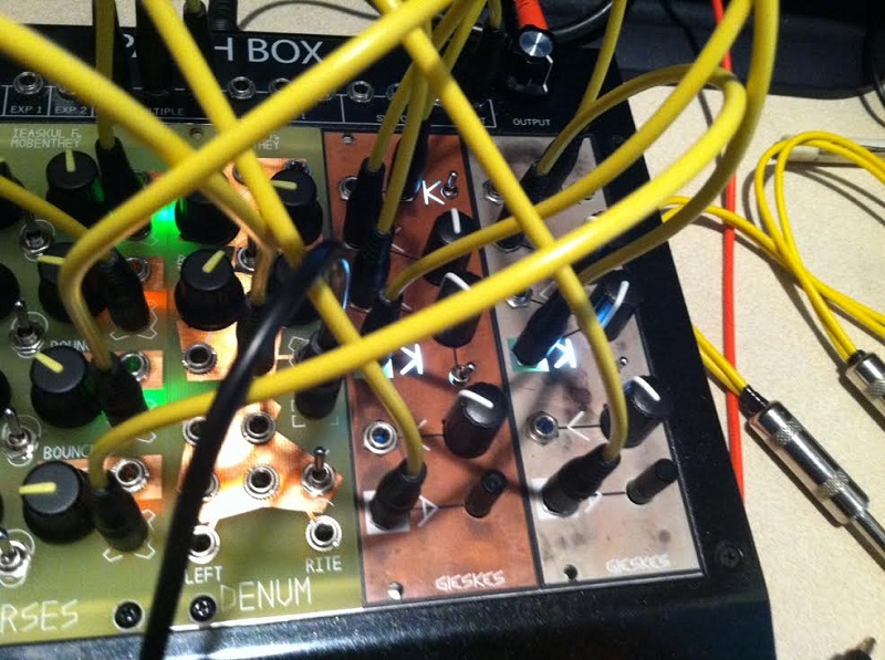

Re: UG demos Ieaskul F. Mobenthey Swoop with Freakshow Hiray
Hey hey, here's a listen to two Gieskes No Drums doing their thing. i.e. "module that tries to sound like drum sounds but mostly fails at it"
Modulated by Ieaskul F Mobenthey Swoop, Fourses and Denum
:joy:
https://clyp.it/xjpkfxt2

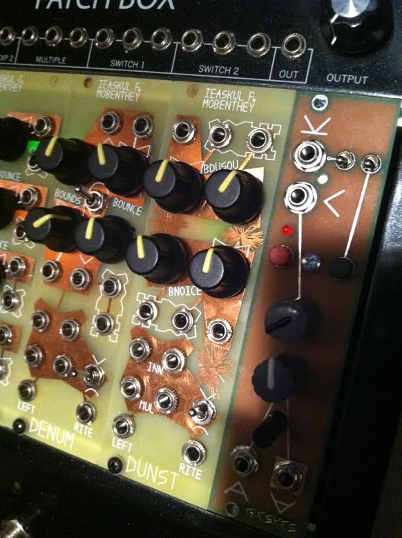

Re: UG demos Gieskes No Drums...Ieaskul F. Mobenthey Dunst n
Hey now, here is a listen to the Ieaskul F Mobenthey Dunst dust and noise module...NOISE :!!!:
It outputs four different sources of noise, and i go through them in order of Noise Pulse, White Noise, Dust Ramp, Dust Pulse. There is some VCA and FM modulation going on throughout, I run them all together at the end. Supposedly the VCA does some sort of left right panning out of its stereo outputs too, but couldn't figure that part out yet. :idk:
:joy:
https://clyp.it/q3cihplh

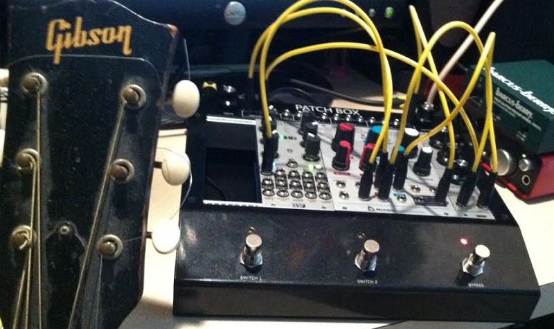

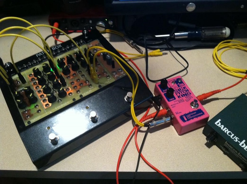

Re: UG demos LAL SPK JR. with CV from Ieaskul F Mobenthey Sw
Hey hey, well this is pretty incredible. Using that modded cable I hooked up CV from the eurorack to CV in on my Lastgasp Art Laboratories Sick PItch King Jr. frequency control parameter. It worked :cool: Went through the toggles and freq range knob, blend was almost 50% the whole time except at the beginning. Its an acoustic guitar into the SPK Jr which is plugged direct into the 2i2 interface. At the end I unplugged the cable from the expression jace, and manually sweep the freq knob on the SPK Jr. I liked some settings more than others, some times the Swoop oscillations seemed disconnected from the guitar signal...which is pretty cool too cause the Swoop is a beautiful farty mess :joy: This little VCA/cable mod trick is really going to open up the possibilities for me interfacing euro with expression/cv input of pedals. Apparently the IFM modules will handle a guitar signal direct in too, but that's for another day :)
:joy:
https://clyp.it/bpxkhcle

Thanks! After I made that clyp I sussed out what was making what do what and when, and I messed around a bit and realized...hey, run the guitar through an envelope follower and modulate the Swoops with playing dynamics :cool: With the mix at 100% wet on the SPK Jr, and with the modulations more apart of the notes i'm playing like in the beginning of the clip, wow i was getting some pretty incredible soundscapes and textures going :yay:

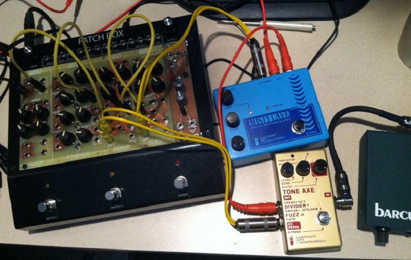

Re: UG demos Lastgasp Art Laboratories Tone Axe & Misty Cave
Well well, hooked up the Lastgasp Art Laboratories Tone Axe into the Misty Cave. Sent CV from a couple Ieaskul F. Mobenthey moduals to their expression jacks using that modded cable/VCA trick. First up is just the Tone Axe into the Misty Cave, then it should be pretty obvious from there. I sorta messed with the knobs here and there as I went along, playing acoustic guitar...which by the way I think sounds pretty incredible with the Misty Cave.
