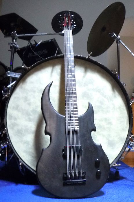

I made a new body for my twelve string bass.
It's elm from a table top I pulled out of my grandmothers garage over 20 years ago so it's probably been drying for 40 to 50+ years.. who knows.. Lace ManOwar MM pickup
the finish is.. I set it on fire and then sanded it and used that driftwood aging stuff, I wanted it to look like you reached into you screen while watching a 30s horror movie and pull it out
sound is monstrous, and balances about like a Bass or a Ric
