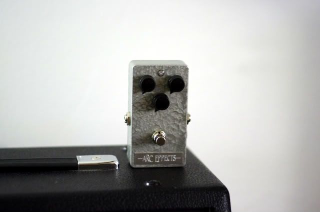

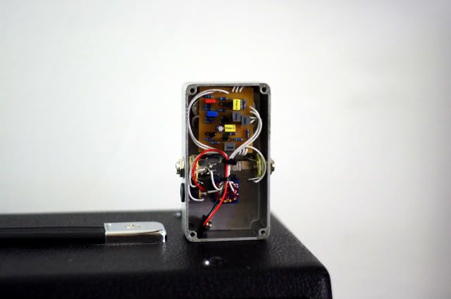

EA Trem
Quick little review of the GuitarPCB.com (the place I bought the board from) :
Pros - Great boards that are impeccable for being hand etched
Cons - Lengthy ship time and I think the price is a little high
I'm guessing the delay was unusual as the owner apologized for the wait but I still think the prices are reflective of fabbed boards with silkscreen/solder mask. All in all I'd order from them again if it was something I didn't need in a hurry.

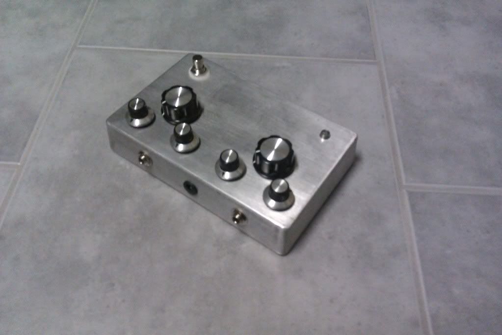

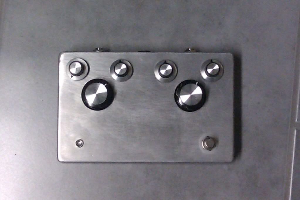

just finished this up:
It's a Green Russian Muff with a added pre-gain stage. The two giant knobs are rotary switches for clipping and tonestack options-
Controls:
top row, left to right: pre gain, sustain, tone, volume
bottom row, left to right: clipping selector, tone selector
The clipping selector lets you choose between standard muff 1n4148, germanium, led or zener diodes.
The tone selector selects between standard muff tonestack, flat tonestack and tone bypass.
A metric fuckton of off-board wiring... but it sounds awesome! :!!!:
