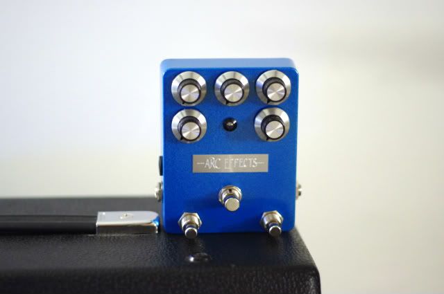

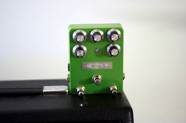

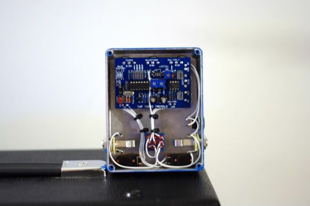

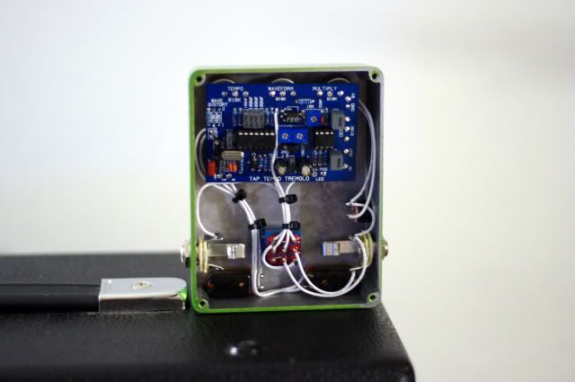

Here are some new ones from yesterday :
Tap Tempo Trems :love:
Tonight I'm knocking out another OKKO Diablo Clone and a Civil War Muff

I love those classy colors. I was thinking about getting a powercoating setup. Any suggestions?

Those are actually from Mammoth but if you want to go the DIY route I used a craftsman powdercoat gun + a toaster oven and got pretty good results.
Living in Upstate NY I've stopped doing my own powdercoating for the winter but come spring time I'm going to look into more professional equipment

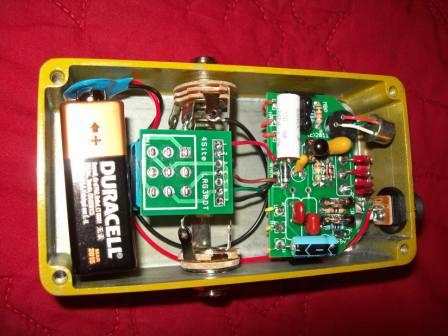

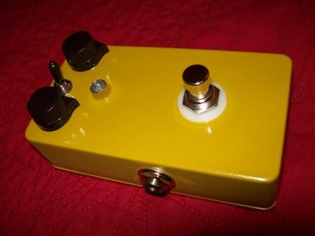

Hey everybody,
I posted this in the Mammoth section too (since I got most of the hardware there), but I just had to post a pic or two here as well. Just go ahead and file me under "way too excited about completing first build" and be done with it...
Anyway, I built this using the Madbean Pepper Spray PCB. It's fuzzy overdrive goodness in the Percolator vein. The toggle lets you choose between 1n695 germanium, 1n914 silicon, or no diodes. I built it to the Albini specs rather than the stock. The guys at the Madbean forum were very helpful with my various newb questions and challenges. This was a fun project and I love the way it sounds.

Nice build there. I etched one of those boards but it didn't work during testing, gotta debug cause I want to hear how it sounds
soooo bad!

Thanks LaoWiz! Definitely post your impressions and pics after you get a chance to debug! I haven't heard anyone else's impressions of this particular version of the circuit besides my own. I've found it is not hard to get some Big Black-type sounds, but much more as well. It's easy to get a Stones-type grind, for example. Also curious about what you end up trying for D4 and D5. The 1n914 turned out to be pretty good--it has the same amount of gain of the germanium, but the added clarity and volume of the no-diodes setting.

I'll report back when I get to debuggin it. I have been listening to Big Black's Atomizer and Shellac a lot lately and that's the main reason I built the board. I'll futz around with it tonight. I don't have the Bat diode but am using some other germs for now.
