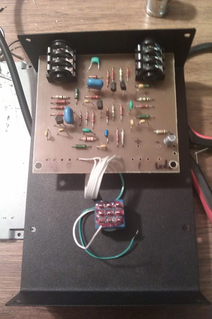

I'm super happy with this Soda Meiser that I built with one of Devi's kits for a buddy on another forum. I wired Q4 on a switch so it's switchable between the SM and VFM. I must have been stoned when I thought of how to wire the switch because I thought I needed a 4PDT for some reason. I used it like a 3PDT although I could have even used a DPDT. Whateva.
Anyways here are some of my classic low res iPhone pics

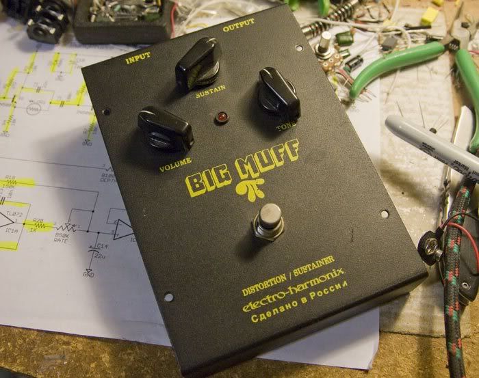

I'm not a battery guy, and the black Russian Muffs don't have DC jacks. So I decided to add one. But I wanted something small and not very noticeable. I'd bought some smaller jacks from Mouser earlier in the year (props to McSpunkle), and I had still had a couple left, so that's what I went with. These are great little jacks, especially if you don't use batteries (it only has two solder lugs, one for ground and one for power). If you want to pick some up, they are Mouser part# 163-1060-EX.
I really dig the sound of this thing, but then again I am a well-known lover of Muff.
Anyway here are a few shots of the insides and finished outside.

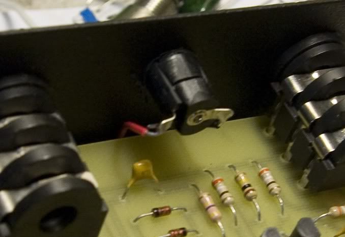

Jack in but not wired.

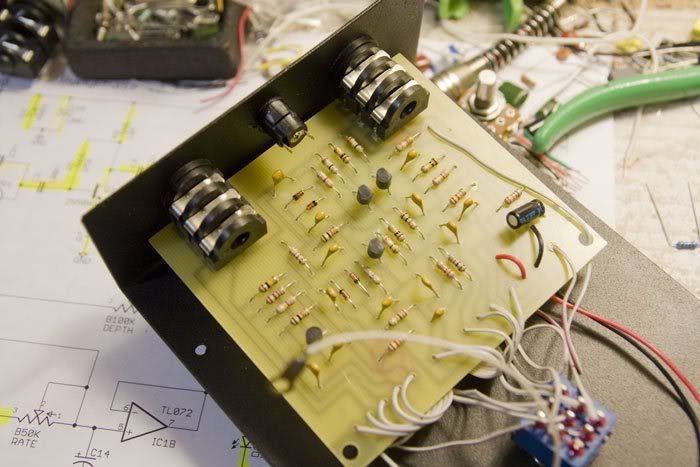

Soldered up and the wires are running back behind and under the board.

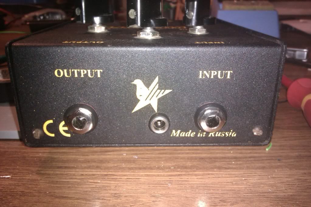

A shot of the cool small DC jack on the outside. (also note the hilarious coincidencidental scratching off of part of the "R" in the "Made in Russia". :yay:

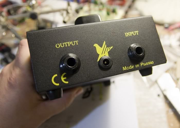

Did the same thing about two weeks ago!
Small DC-Jacks rule:
I also modded it true bypass:
obviously not finished yet.. but I didn't take a photo of the finished pedal.. so yeah... :facepalm:
oh also- high quality neutrik jacks :thumb:
