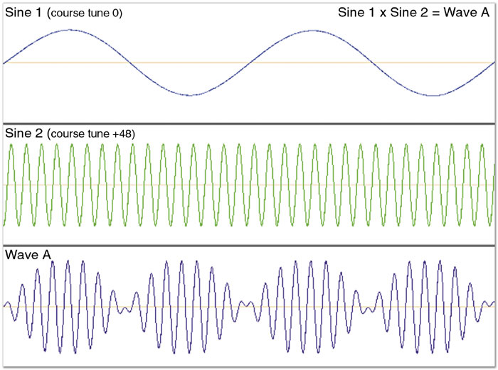

Ring Modulation is the sum and difference frequencies of input and carrier signals that can be used to do a lot of different things (including some overlap with Hysteresis).
Ring mod is a specific form of amplititude modulation. FM changes the frequency instead of the amplitude (volume). But the Hysteresis can do amplitude modulation (trem) too. I think what it does is kinda does a fast trem to modulate the signal (ring mod like...playing a trick on the ear but still keeping the pitch related to the original signal and then it modulates that...like a trem made with a pll chip...the holowan does this with envelope and the Hysteresis with lfo).
Basically the carrier wave and Modulator wave to do not change shape based on difference like in ring mod....the frequency of modulation changes at audio speeds. A true frequency shifter (which none of these pedals are) will change the incoming signal via phase (to cut out the unwanted modulation and only have the shifted wave...not many out there though).
Wikipedia wrote:
Ring mod(way better examples in the ring mod thread...lots of modular ones too).
