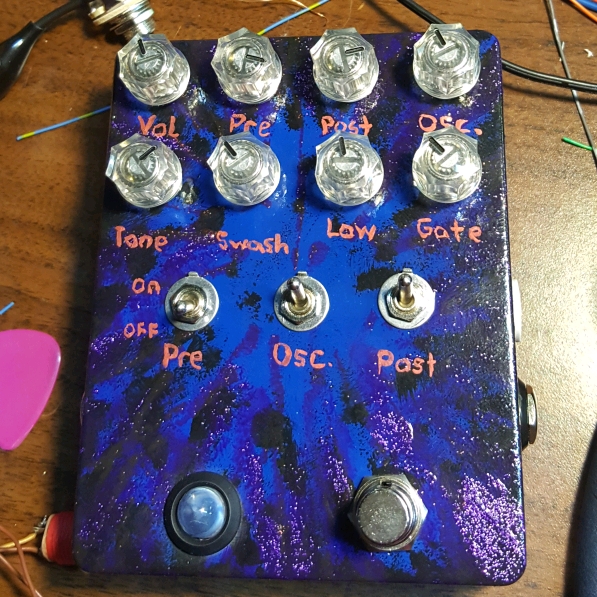

Well I built a Noise Swash .. It's pretty rip. Did some glitter shenanigans on the box.

Glitter shenanigans is the name of my next noise pop band

Whooooooo, looks dope! Mermerizing actually. Mermermeeeeeeer. I would like to make such a thing.

Thanks guys. Yeah the hand drawn stuff is lots of fun. I'm doing water colors now on some stuff. I can definitely do labeling much better with a fine tip brush and water colors.

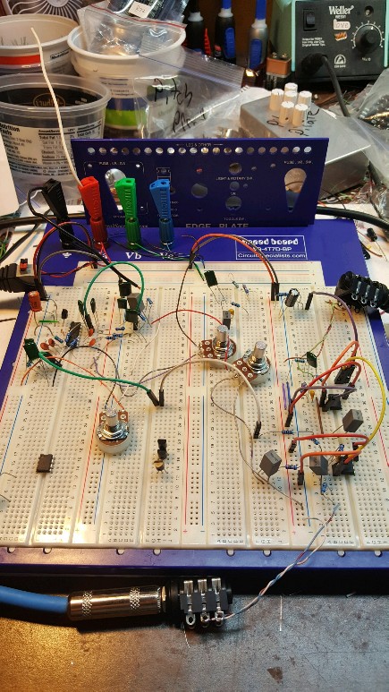

Well my breadboarded delay is coming along pretty nicely. I've got the effects loop working ok but I want to try a few different types of buffers to see.. I am going to try a transistor, jfet and mosfet buffers.. I've got a couple TL072s going now. I'm curious if the jfet and transistors do in fact sound any less sterile. Sterile is ok for delay right?

Looks neat! I want a breadboard like that... got two small ones that I link together when I need a bigger one, but it still amounts to half the size of yours, minus the power strip and edge plate. Not much space for things like a delay.
However I did a bread based on the crap-fi delay recently. It got out of hand with lotsa diodes and an MPSA13 gain stage though. Somewhere in the middle of that process I got some very cool sounds, like one configuration where it seems the diodes gave me control over the spacing between double-tap delays for interesting rhythmic effects. Unfortunately I lost it and ended up with a super dirty thing where the gain and delay was all intertwined in a way I did not understand. But that might be because there wasn't a buffer/blend in there to begin with. So it goes, tear it up and start again.

Yeah man that shit was like $22 on eBay. Totally worth!!
When I'm breadboarding from a known circuit I always print out the schematic and once I change something I like I write it down on the schematic. This particular delay is based off the rebote 2.5 with more aggressive filtering and feedback loop values closer to culturejams Triton.
I'm playing with Germanium for the effects loop buffer.. it kind of gives it a little heat. Certainly not a "clean" buffer, but it only gets a little hair as you boost past unity.
I've also been messing around with the Noise swash standard and a depth knob on the LFO.. pretty cool. I love my 8 knobber.. 12 will be even more fun
