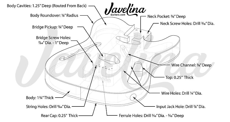

yeah, that's the big drawback to Dynas, the mounting depth. the good thing about thinline bodies is that the top and back are fairly thin so in theory there should be more room for those great honkin' huge magnetized polepieces. unfortunately, i don't have a thinline body to measure. icm pretty sure i couldn't put Dynas in the Special Jet without them sticking out the back. happily, the stock pickups are about 87% as good as Dynas, and i'm totally happy with them.

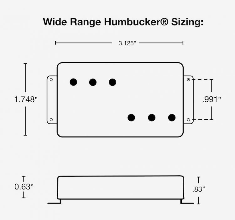

it was, as my dear departed mother would say, the absolute dickens to find the dimensions of non-standard Telecasters, but i did manage to find a '69-style thinline Telecaster routing template. the body is 2.25" in total depth with a 0.25" front and rear cap; an alternative might be the Tele model routed for WRHBs, which obviously require larger/deeper, rectangular routs. mounting depth for WRHBs is 0.63" at the neck and 0.83 at the bridge, so there would still be whittling involved but quite a bit less of it. the WRHB Tele bodies are also slightly larger that a standard Tele. you'd probably be able to get away with mounting the pickups to an unrouted pickguard, which in the case of a multilayer guard could gain you maybe 1/8"-3/16". so there you go...measure the Dynas and we'll see what you've got.

i have the Dynas out of my Pro Jet to ground the pickup covers, which Gretsch inexplicably does not do on the stock Tokiwa-made Dynas, and thus was able to measure the mounting depth for the bridge pickup, which is approximately 1 inch. the neck PU will require additional depth equal to the difference in height between the pickup covers, but that shouldn't require more than 1/3 to 1/4" of additional depth. so the thinline Tele looks like a "go" for launch. the 1969 style would look really nice with the Jetsons covers, especially if you drew up an altered MOTS pickguard based on the original profile which would offer a mounting surface in places the original Telecaster pickup routs--the bridge in particular--might overlap outside the Dyna footprint. if you decide to do this, i know someone on the Gretsch Pages who does really good custom work, and i'd be more than happy to hook you up. obviously some routing of the guard would be required for the previously mentioned great honkin' huge polepieces, but he can do anything within reason if you give him the measurements.
