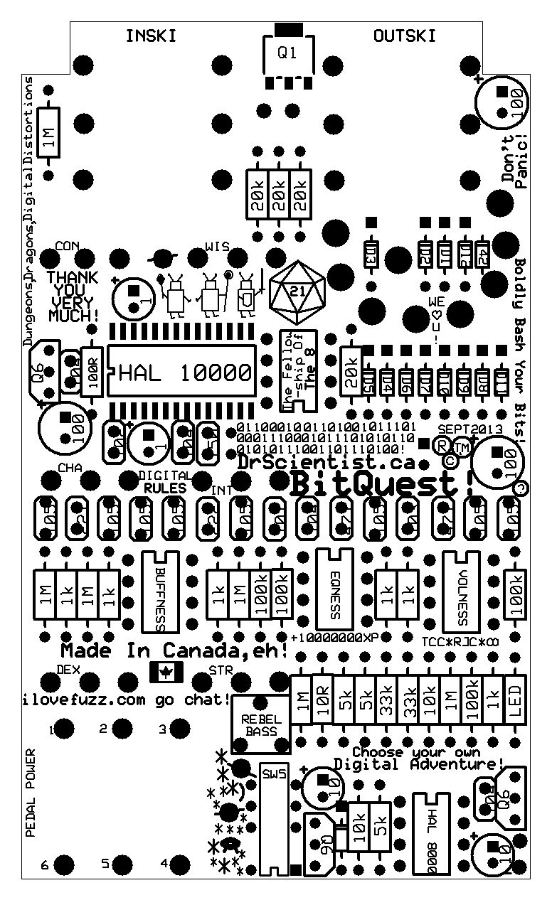

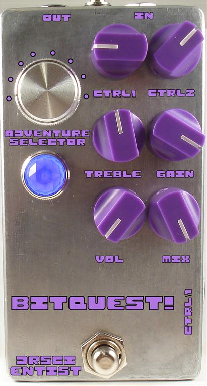

This week I made the first BitQuest in real life, the first proto is borned and it works perfectly!
Here's the layout image:
I don't know exactly what we'll do for the finish or knobs, this is just for fun, but I could see it having the jewel.. jewels really suit an adventure quest in my opinion. And I just added the labels in Picasa but that's how the controls will go.

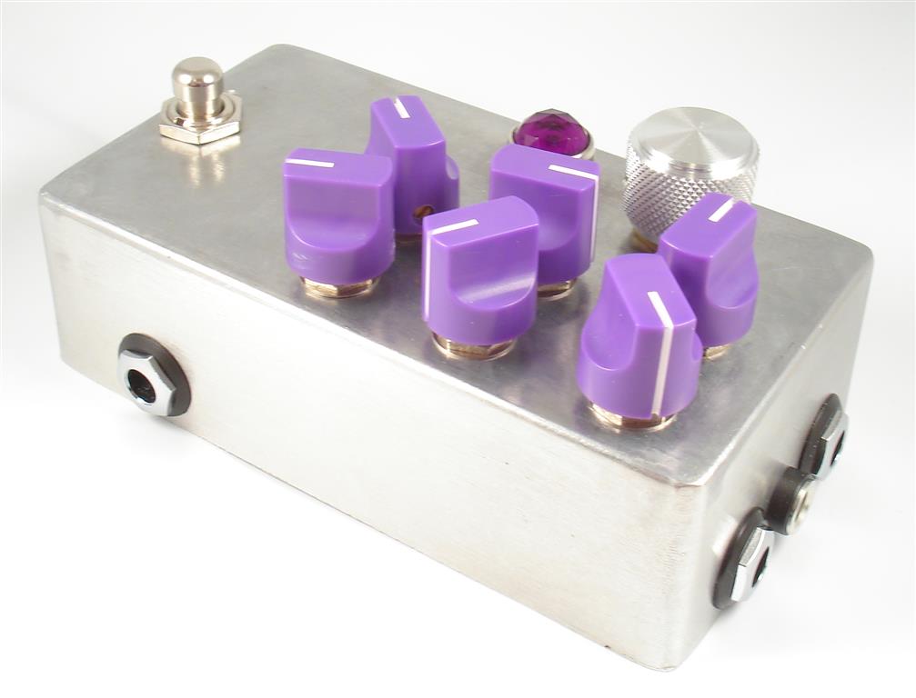

Side shot for jacks.. the expression jack will take over for digital control 1 letting you run the cool parameter of every patch with your foot. (filter freq, notch freq, pitch, delay time, sample rate, reverb decay, one cool control for each patch)

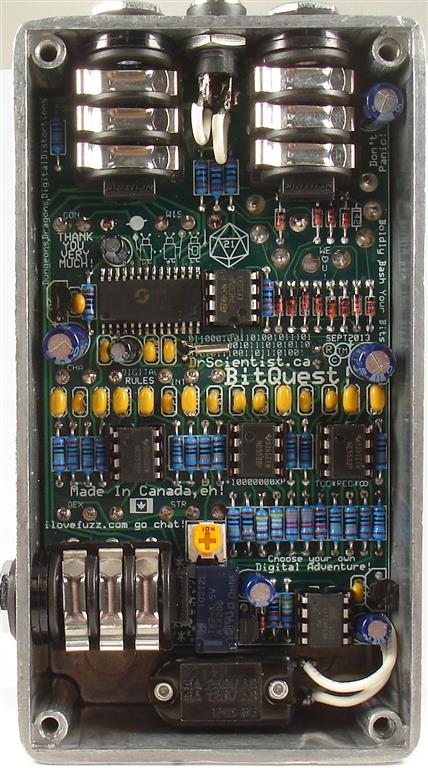

Kind of a tough build but that's part of the fun of the adventure!
So the box and pcb are pretty much sorted... now I just need another weekend or three to finish the code!

Re: BitQuest! First proto build page 11
Post by Derelict78 »
That is fucking sweet!
Have you figured out what the 8 adventures will be?
Post by intothegroove »
Holy macaroni! :love: Awesome Ryan! I love the Jewel LED :drool: :!!!:

The binary says bitquest! guys so theres that. Maybe labeling the presets 1-8 would be a good idea to make it easier to remember otherwise it looks great so far...can we get a taste test?

And I agree about possibly numbering the modes? It just might be easier since with that many modes, one wants to easily be able to tell which one they're using.
