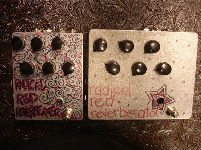

I've basically got 2 pcb layouts ready now, rounded up all the parts I need to experiment with, and am now just focusing on getting the pcb prototypes ready so I can build a couple protos and really make sure some of these features will work in the box. I'm still debating the box size too, I'm still on the fence a bit about what size to use. I've got a layout ready for the 1590BB, horizontally positioned with side mounted jacks. I've got a layout ready also for the 1790NS, horizontally positioned with top mounted jacks. I'm also doing a layout for the 1590DD, horizontally positioned with top mounted jacks, as I don't have a good source for the 1790s but I can get the 1590DD through 4Site and I could use the extra space too that the DD provides anyway.
The features that all of the prototypes will have are:
-true stereo in and out, 2 fully separate audio paths
-decay control
-global modulation with rate and depth controls
-stereo expression control for mix (controls both channels with one exp pedal)
-expression control for decay
-soft touch relay switching
-beefy power supply protection that can't be hurt by reverse polarity adapters
-*maybe* - internal choice of buffered bypass or true bypass
There's not really any way to add a predelay knob.. the thing is, I have no control over the patches or the digital aspects of the circuit. Even my decay control is totally an analog hack that wasn't meant to be used with the chips but I'm making it work. I can only add analog hacks to the circuit, nothing that affects the character or nature of the reverb patches. Adding in a circuit for predelay would just add too much complexity to a circuit that already has over 150 components plus more than likely it would have a negative impact on the sound quality of the wet signal. (That's an assumption based off the fact that I don't have a really clean and transparent delay circuit readily available to slow down the signal going to the reverb engine.)
-decay control

Whew, glad you guys like the sound of those upgrades!
Thanks for the links to those guys, Kevin, I've been using Small Bear to get my 1790s for prototyping. For the record, I've done lots of business with both of those stores and they're both awesome.
I've spent the last few days totally focused on another box layout that I think is my new favourite, although it's by far the toughest for the pcb layout. I'm down to two favourite box layouts now, one in the 1590BB and the other in the 1790NS.
My plan now is to make pcb layouts for each of these boxes and build them both and then see which one sounds better (lower noise) and builds better. I really like using the smallest size box possible but the circuit is so jam packed into the 1590BB that I don't know if it's a great idea... mixed analog and digital layouts usually like some space between everything. The expression jacks are on the side of the box as that makes most sense for building as I can use pcb mounted jacks in that position and save the chore of wiring 12 connections just for those 2 jacks. Otherwise I'll be using my standard Switchcraft jacks in my standard top mounted position and I'll standardly hand wire them as usual.
I'm hoping to have these pcb layouts ordered within the next couple weeks and then we'll really get to know about some of these features, like the decay control I worry so much about.
