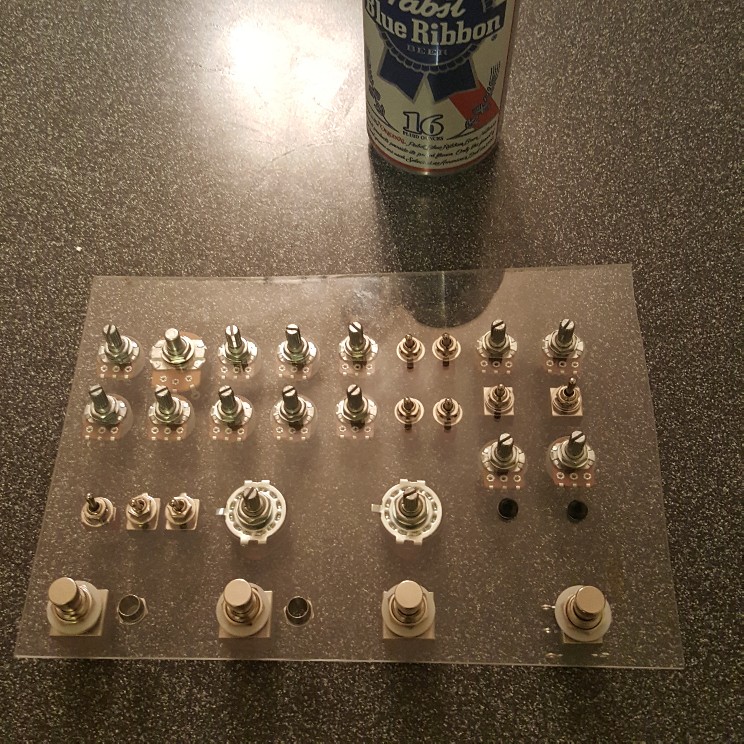

Well I've put some time into this tonight after I messed with my harmonic percolator. Which now is beginning to resemble this as it has like 4 toggles and 2 stomps in a BB box.
Anyway. I found a piece of plexi glass that's a little bigger than my box so I marked it to match and drilled it out. Then mounted my parts.. my board is also ready to solder

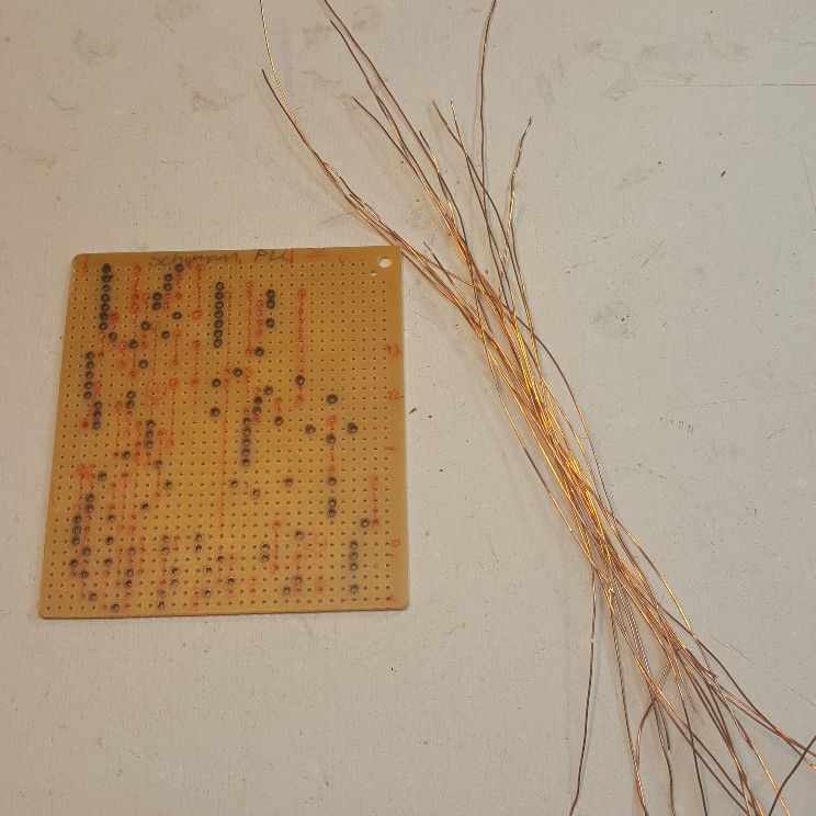

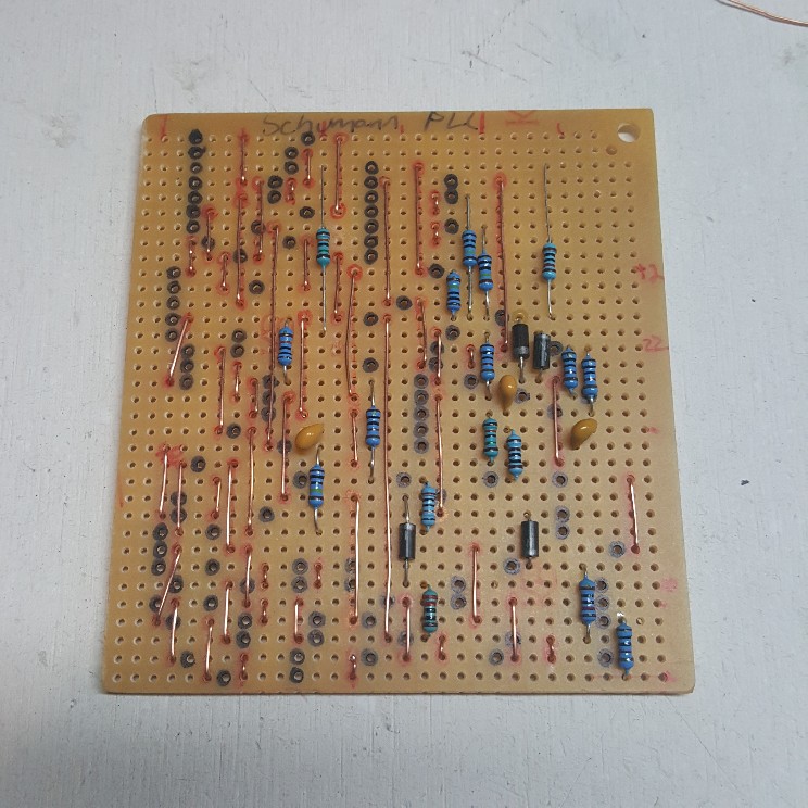

Little progress. It had 54 links .. that took forever.
Got the resistors and diodes in. I think if I leave the other two out I can try my 9VDC supply with the daughter boards. I think I'll try it and if it doesn't work I can just install those 2 diodes and the 337 and 317s.

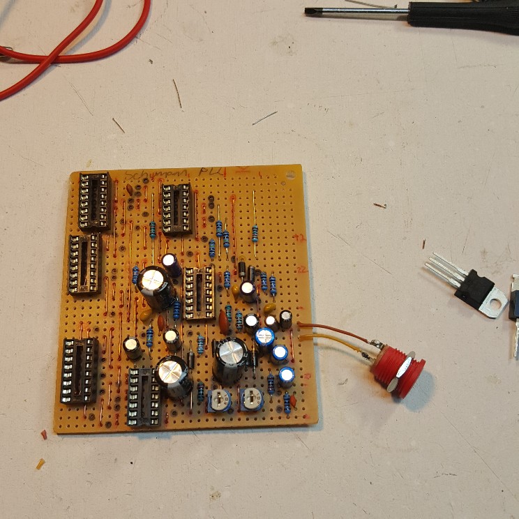

Well tried the daughter boards and they work great, but I don't have a reliable source of negative voltage without making another daughter board.. so I just decided to go with the AC power. My adapter puts out 13.8VAC no load, so I'll just use the 337 and 317.

Well I soldered in the 337 and 317, plugged in the power adapter and nothing. It didn't work at all. I drank a beer and then realized I had plugged in my 9v DC power supply.. which was not plugged into the wall.. So then I plugged in the AC power adapter
and then dialed in 12 v on both sides! So now it's just wiring. Not so bad

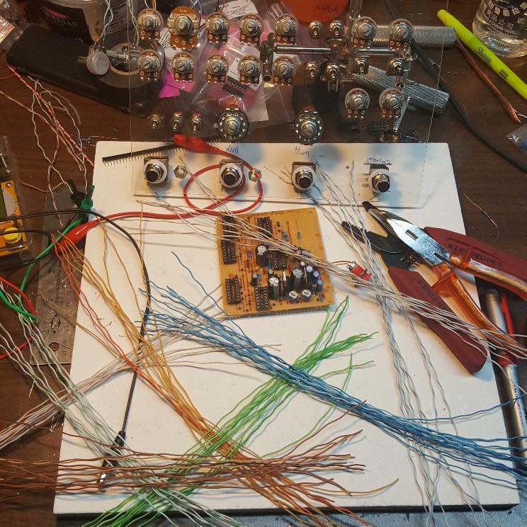

I stripped like 80 wires, roughly 12" long, and then started soldering them all on. It's a big spaghetti mess.

Are you keeping the plexy/lucite faceplate? Maybe sink some LEDs into the mess that will strobe along with various frequencies?
- BetterOffShred
- Posts: 3412
Re: B.o.S. builds a .. robot fart machine
Nah, it's just my wiring template so I don't have to wire it up in the box. It's a G size box, so it's 2" deep. I have a bunch of little pink zip ties so I'm going to try to keep the wiring fairly tidy.. but that's what I said about my Skyripper and it ended up not so neat ..crochambeau wrote:Are you keeping the plexy/lucite faceplate? Maybe sink some LEDs into the mess that will strobe along with various frequencies?
