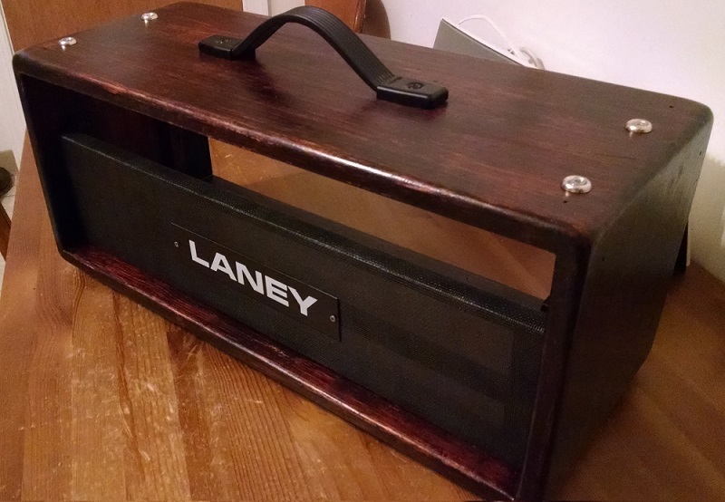

I did a head similar to this.... After I peeled the tolex off by hand I used an electric sander to get all the glue/goop off. Even with my belt sander it took several hours to get it all off and clean enough to stain. I'll post a photo of it later, I used cheapo ACE brand walnut stain on the pine and I think it came out good (not in a traditional stained woodwork sense).

This was just cheap pine board shell I made with several coats of dark walnut stain, I rubbed in/wiped the first one and sanded after, the additional ones were light brush ons and not rubbed in or sanded, I did do a little fine steel wool after the last coat.
excuse the bad cellphone photo....

Iommic Pope
Posts: 11400
Re: Tolex removing and staining of an amp & cab
Post by Iommic Pope »
That is very slick dude.
