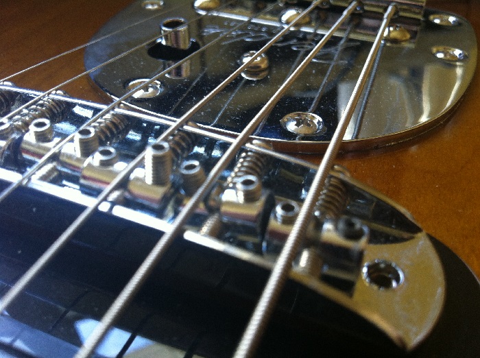

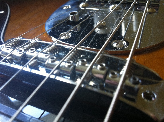

So quick comparison of the bridge before:

about 10 minutes of playing.... :facepalm:
I think I'm going to order that Warmoth bridge right now

So did all those screw just back themselves out of the saddles...???!!!!

Decibill wrote:So did all those screw just back themselves out of the saddles...???!!!!
Yes. Yes they did... :mad: :grumpy:
If I was going to keep this bridge I would need to invest in some of the blue loctite
But I ordered the modified Mustang bridge.
