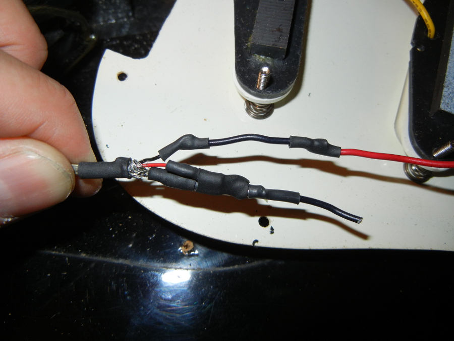

Edits: If I wanted to add an optional/toggle-able switch for a stereo bass output, would I wire it: pup > volume (I would want it to have its own volume) > toggle > output A/B ? Does that make sense?
Any thoughts as to which wire is the ground on this here Carvin H13B blade-style bass Pup?

OooooooK. For controls, I'm thinking:
-Neck and Bridge HBs each have their own volumes, wired to the main output
-Bass pup has its own volume, wired then to a toggle/splitter to go to it's own stereo out or combined with the guitar pups
-Kill switch wired between the guitar pups and the main out, so I could kill the guitar signal and play only a bass signal
Make sense? Would it work?
My brain is about kaput for the day, but I feel like I should keep a pup selector for the two guitar pups. If I wanted no bass signal, I could either turn the volume down or switch to stereo without the bass jack plugged in.

Contact mic would be cool. you can get one at stewmac for mandolins for like 30 bucks I think.
I dont know how youd be able to wire all 3 pickups to the same output though. I can only imagine you having 2 jacks and running a kill toggle on each one for switching. Not a wiring master though to be honest.

Plus it would be less easy to fuck up your changes.
Bass and guitar both on, flick one switch to kill guitar signal.
Bass and guitar on, flick other switch to kill bass signal.
Vs
having to turn a knob real quick and maybe forgetting which way its turned while rocking out/ hitting it by accident while strumming hard and fucking up shit.
Are you planning on running two different amps or are you intending to get a Y cable and mix them down together for one head?

Skullservant helped me figure out the wiring: http://ilovefuzz.com/viewtopic.php?f=192&t=36049 Props.
This way I can run into one amp, or into a guitar amp AND a bass amp. If I put a contact mic or piezo bridge in there, I'll just add another kill switch and wire it to the guitar output.
