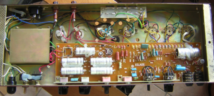

only thing that remains is to marry the board back to the chassis mounted components.
Anyway, only two known issues, just before I go nuts.
There were two green wires from one of the trannies going to pins 9 and 5 of V2, I labelled them, but the labels fell off.
WHAT ARE THESE? and does it matter where they end up? In other words, can I get them around the wrong way? What will happen if I do?
Also, Black wire from the same tranny junctioned with a black wire coming off the board where its marked "T", near the big filter caps, and another from the 4ohm output. These were all soldered together on the third lug of one of the old big caps. The new big caps only have 2 lugs, and I've sorted them out, so what do I do with these?
Please, help fellas!

I got to play around the other day and I got five minutes of play time or so before the amp just died and stopped firing up. No pilot light. Nada.
It was awfully noisy while I was playing and the buzz from the tranny was quite awful.
Things I am aware I have done wrong in order of suspicion.
1. One of the gnarly gross wires (that I think may be covered in arsenic goop) that runs from the tranny to pin7 V5 is not actually wire inside, but a sold copper sort of deal, and it didn't take to being soldered onto its pin. Pretty sure it came loose while playing. Pushing it into contact while the amps on (with a set of wooden chopsticks) does effect the intensity of the buzz. Would also explain why afterwards only V1 was powering up.
2. I only have one power tube with a screen resistor at this point. I've heard that can have a humbucking effect, so it'd be nice if it was that simple. ???
I had a packet of em lying around but they've gone walkabout and I've not had time to get replacements. I know it was risky for the tube and all, but I had to suss it.
3. I've put a few things in the wrong place. I know its wrong now, but at the time, I didn't know what else to do.
Basically, the black wire that comes from the transformer to big cap on the left of the photo, meets a black wire from the board there (marked "T" on the board) as well as a line from the 4ohm output on the sleeve of this strange russian cap, that is not actually an earth (explanation below also).

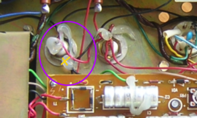

Area of interest. X is the strange terminal.
What some other dude did with his two pole filter caps.
Schematic: http://www.blueguitar.org/new/schem/sovtek/mig-50.pdf
Here's that explanation of that extra pole/not-pole. (Original thread here http://offsetguitars.com/forums/viewtop ... 10&t=34258
for the MIG50:
the big ones standing on the chassis are single 220µF/350V caps each.
They are the 2 serially connected 220µF caps in the schemo that chieljan provided;
(plus-pole of the upper one in the schemo/right one in my pic, goes to to the standby-switch,
while it`s negative pole (=the metal can, which is heavily isolated against the chassis),
goes to the positive pole of the schemo`s lower cap/left one in my pic,
who`s negative pole in turn goes to chassis/ground);
This wiring makes the 2 an effective 100µF/700V cap,
who has the HV equally divided across the 2 halves
by means of the 2 220k resistors.
Physically, the pluspole of each cap is a ceramically isolated central solder-lug
on the bottom of the cap (inside the chassis),
while the negative connection is being made by a large washer with solder-lug,
which is screwed to the metallic base (also on the bottom, inside the chassis)
by a big nut, which also ensures the physical mounting.
NOW: this is the dangerous part:
this large washer and the nut LOOK like ground,
BUT the right capacitor`s washer&nut ARE NOT!
They are isolated against chassis by another, isolating washer,
which at first glance is not visible!!!
This invisible (epoxy, plastic, or hardpaper) washer,
and the rubberisolation on the outsidesticking side of the right cap
are intended to isolate the half-HV against the chassis-ground,
and against touchy hands of nosey service-people.
DEADLY voltages lurk HERE!!!
So basically, I put those three wires on the -ve pole of the filter cap. Which I know now was very VERY wrong, and could account for a lot of the buzz and trouble. But, I'm stuck as to where they should go now, as the caps I used to replace the old ones only have two poles.
Where do these actually need to go?

Ok, just spent some more time battling the Mig.
Undid some known mistakes, possibly created more (cold solder for the win), just want to get it to the point where it fires up and makes noise without tripping out.
Had a crack at trying to figure out what old mate did in the photo above. It looks like he sent the black wire coming from the tranny (previously one of the three that went to the weird ground terminal of the big filter cap) to the -ve terminal of the cap that replaced it, which then seems to be jumpered by a wire (maybe a resistor) to the a clamp mounting scew; the black from the board (the second of the three) to chassis ground at the screw that mounts the cap's clamp (hard to tell from that photo), and the black from the 4ohm tap (the third) I can't really tell, potentially it looks as though it goes to chassis ground on the other filter cap's clamp mount :idk: . I have no idea what happened to the lead coming from p7 of v5 that went to that caps -ve and then to ground. It may be directly going to ground.
This photo is really crap.
Could anyone compare the pic and my guesswork to the schematic and tell me what the frig is going on here?
