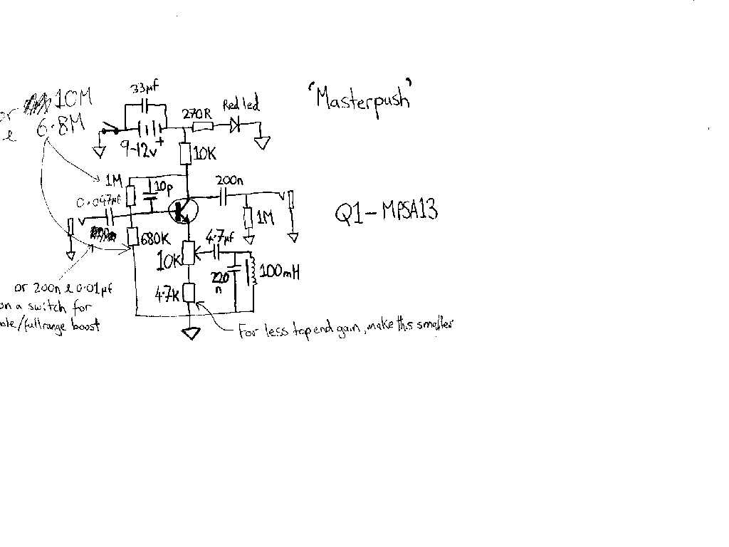

I've posted this elsewhere,but thought I'd put it here for better placement
It's a booster I designed that has the same amount of gain as an SHO but with a different circuit
You can make this,sell it,without any worries
There's enough gain from it to put a passive eq or diode clip on it ok,to turn it into an overdrive
Feel free!
The choice concerning resistors is if you want a little sharper response
Any npn silicon tranny will do,but the mpsa13 or any other npn darlington is best
It's called the 'Masterpush'
Gettit?
