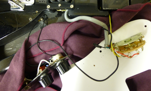

No shielding anywhere on the pickguard. And spotty shielding paint in the cavity. Not a huge deal--the control plate is metal, and the wires are shielded. But it's nuts--even the Squier Duo Sonic's aluminum pickguard had aluminum shielding tape on the back! :wha?: :facepalm: So I'll be shielding cavities.

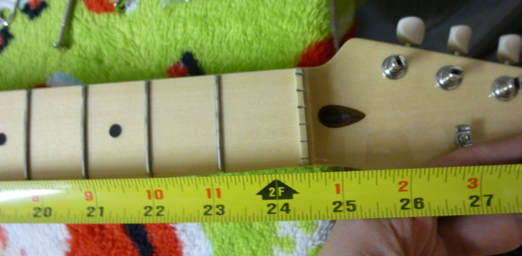

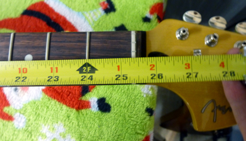

First, a Modern Player Jaguar neck (same series) that I thought I'd try first. No dice. Had a feeling that, even in the same series, Fender wouldn't be using a 24" conversion neck. :facepalm:
Also had a Squier Duo-Sonic neck here that I figured I'd try...don't really want to Squierify a Fender that's already fairly close to being a Squier, but the neck was closer. Closer. Maybe a 1/4" from the point where you could get some longer screws for the saddles and move it into place.
SO. I know that Warmoth's 24.75" conversion neck would fit...IF you rout just slightly underneath the fretboard overhang. So that's looking like the next step. The stock neck/fretboard actually plays great for a 25.5, but I prefer shorter.

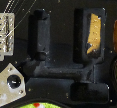

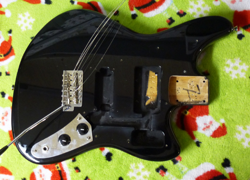

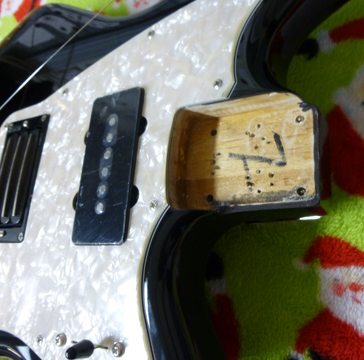

For reference, here's the control rout and pickguardless body.
Gonna have to mod the tabs on the bridge pickups to get them to fit in the humbucker rout.
Getting reminded all over the place how much easier it is to mod the Fenders that everyone else is modding. Or go Warmoth. We'll see if I lose my mind and replace every single part. :lol:

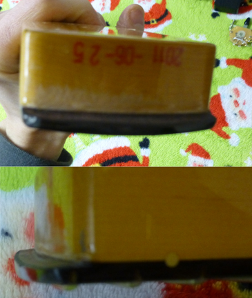

To get a Warmoth replacement or conversion neck to fit the Marauder, you have to shave underneath the fretboard.
Funny thing is, Fender apparently did this themselves to get their neck to fit! :lol: :facepalm:
