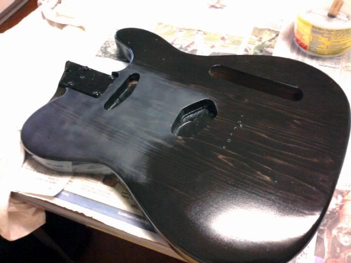

My last thought that I'd like some feedback on- finishing the body.
Had a few possible ideas for finishing the body:
1. Just clear coating it and leaving it as is, its got a decent grain
2. Getting a butane torch and burning the pine a little bit to bring out the grain before clear coating
3. Ebony staining to match my Verellen cab, then clear coating
Figure if I was to stain, I could skip out stripping and staining the Jaguar, possibly.
- skullservant
- Posts: 16575
Re: My First Tele (Poll Inside)
A better idea of ebony stain:
- MEC
- Posts: 4651
- Joined: Sat Jan 01, 2011 4:04 pm
- Location: Old North State
Re: My First Telecaster (Pine, P90 neck, telebucker bridge)
Yeah, the Ebony would look cool but the grain is cool too. You can always test out colors underneath
where the pickguard will go to give you and idea what it will look like.
