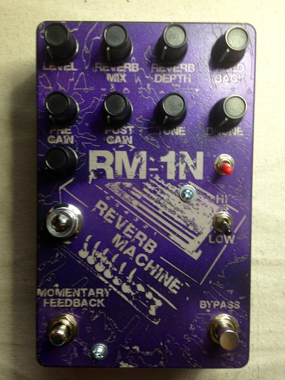

First one complete!!!
this is being shipped out to doommeow tomorrow
Thank you so much for being so patient buddy! I really appreciate it!
So people have been asking me about mods to their RM-1N's so I set the circuit up on the breadboard for testing out different things, and once again I have found two more major mods to the circuit that I feel totally completes it as what needs to be the standard
One is the red switch which brings the trails and decay (reverb length) into Infinite feedback with the right amount of mix and depth dialed in, this mode disables the feedback pot and the momentary footswitch but allows for extremely long reverb lengths and infinite lengths
The other mod is the extra pot right across to the left, the reverb is generated by a small module, a Belton Brick, It has two outputs which are now available for tweaking
I find that to the far left is wide open with more modulation and a long decay, all the way to the right is a way more bassier and darker reverb, and in the middle is both outputs. This mod has also boosted the reverb output and has uncovered some characteristics of the sound in the circuit
I also fixed up the tone knob for a deeper darker low end.
If people are interested in the extra mods, which will be standard on the smaller sized RM-1N when I get the PCB's made, I'll message them before I build theirs and ask if they would like the mods. They are going to cost a bit extra, and prices have gone up at Canada post here for larger sized parcels with tracking and insurance, so the extra cash would help out a lot. I can of course send them without tracking but it would take long and not be insured
Thanks everybody!

Oh fuck yes.
Too busy drooling over the pic to do something as meh as reading words.
Purple.
Come to daddy.
Purple.
