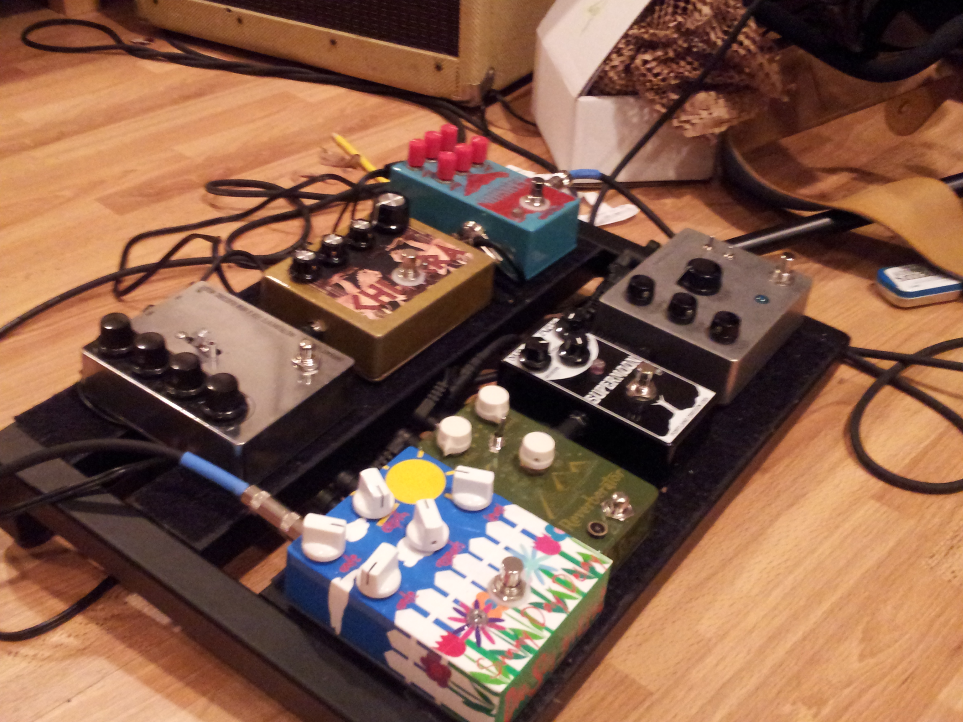

Can't wait to slap a CC v3 on that board! Got the weekend off so I'm gonna have fun with this (minus the Malekko Phase and TS-9). :!!!:

Clean Channel wrote:Raintes: your board is awesome.
Thanks! I love the sounds coming out of my amp speaker! Dr. Scientist pedals rule!

Raintes wrote:Thanks! I love the sounds coming out of my amp speaker! Dr. Scientist pedals rule!
Thanks Manuel! Your board is killer and I appreciate it!

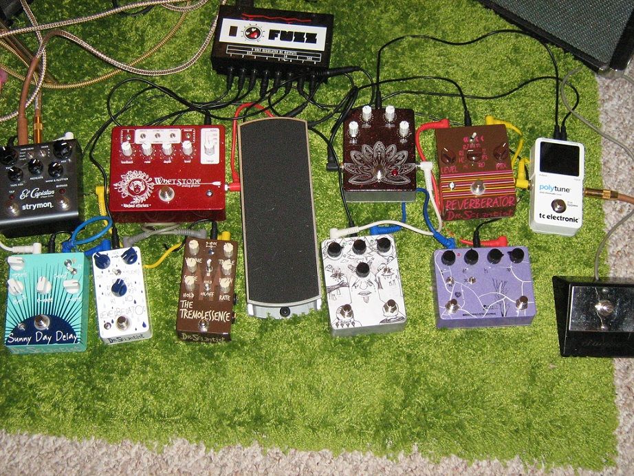

Totally awesome, Colin! 2 RRRs, geeez man, I like your style! That big box is a one of a kind for sure, pretty cool to see it again.
colin
Posts: 2422
Location: BC
Re: get yer Dr s boards out for the lads!
Post by colin »
Oh cool, didn't know that RRR finish was the only one like that! I managed to snag it in a trade off Vancouver Craigslist of all places.
