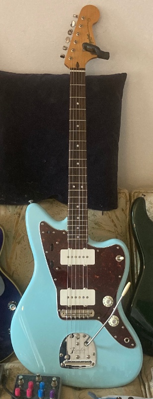

since we last spoke the new blue CVJM arrived. it turns out that i didn’t need to do nearly as much as i expected. i actually like the electronics in the new JM better than the old ones, which i was quite happy with. and the laurel fingerboard is as smooth as the rosewood board on the old one. so in the end all i had to change out was the bridge, tremolo, and the white amp-style knobs. i didn’t even have to re-intonate it.
everything for the first pass on the baritone is ready or on its way. i got a stainless steel version of the tailpiece which should be better for the added string tension. i decided to make it easier and found an unusually low-output Telecaster bridge pickup (3.8kΩ) which should balance better with the JM pickups. i’ll use the Mustang-style bridge that came with the new JM.

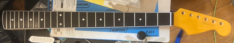

i’m still processing the neck, but should be done by the time the tuners come in. it had to be sanded because the finish was Not Good, and once i had it down to 1500 i liked the satin neck feel so much i decided to stop. the board is sanded from the end up to the 14th fret and is coming along.

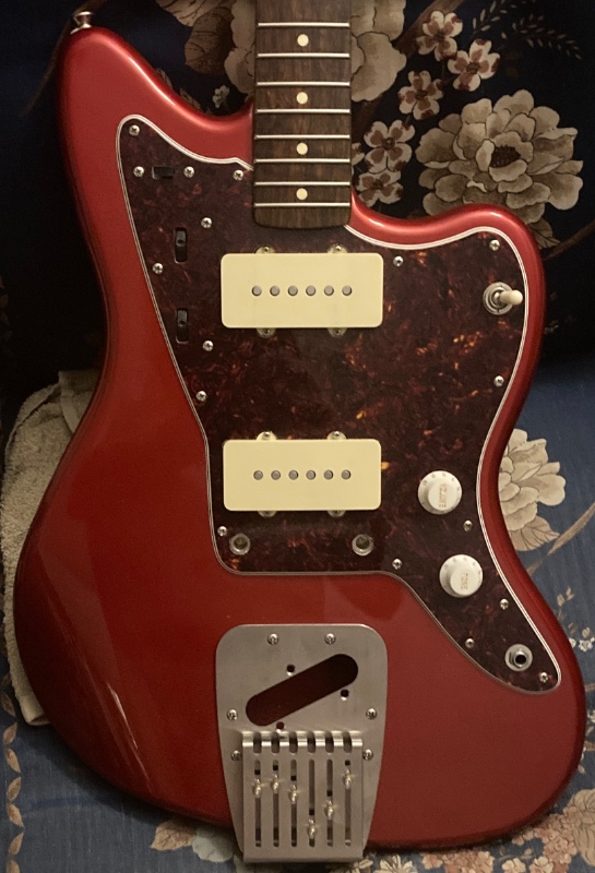

the tailpiece arrived and it’s quite a thing. you don’t think of it being that large and deep. i got a stainless steel version which i’m glad of because it’s getting BIG FAT STRINGS. the entire design is very impressive for what i assume is one guy in a basement workshop. i doubt i’d have come up with a design for this…i don’t have the machining and metallurgy chops to do it. it’d be interesting to see the discarded prototypes as a window into the thought process.
dropped straight into the trem rout and looks/feels solid as hell. it doesn’t seem to make the guitar butt-dive too badly.

the tuners arrived. i’m not going to install them till i’m done with the fingerboard, though…the face of the headstock has some rub marks already and i don’t want to sand any more before it’s done. they appear quite stout and stable. i’ll probably change the buttons for something more aesthetic, though. Schaller-style knobs are boring.

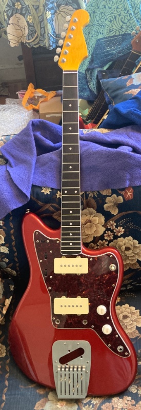

i finished off the neck and did the preliminary assembly, and i couldn’t be happier with how it’s coming out.
the tailpiece and tuners are great, real quality assembly and tight tolerances. the neck fit so tightly into the pocket that i had to tighten the bolts until the screwdriver wouldn’t turn any more. which means it’s going to resonate like a fucking gong. this thing gets dangerously close to violating one of my Reality Rules: Never Wear Something Cooler Than You Are. but then i think of Cole out of DIIV, and what a total nerd he looks like while grinding out his fuzz-laden chords on some extremely cool odd Fenders and am like “OK.”
