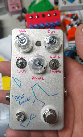

Finished boxing the Naughty Stir PLL 2.0. It's a pretty bananas pedal. It will do burly fuzz and then 2 modes of 4046 PLL stuff.. the non glitch mod "Smoov" on my pedal still has a little bleed through so it's definitely not straight up fizz. I built it a year ago and then never boxed it, but socketed the input cap and transistor .. which fell out.. so I tried a few values before I boxed it up.. 100n and a 2N3904 sounded the best through a bigger amp. Lots of fun.
