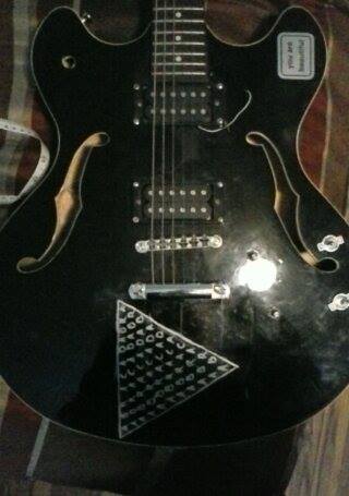

I got this guitar from a roommate (partial loaner, but i have free reign) the electronics are absolute nonsense right now, because I think I wired it drunk.
Master volumes for both pickups, the bridge one is wired backwards, a phase switch, and a series parallel switch. But something's up with the grounding, so sometimes the switch configuration acts as a reverse killswitch and the volume comes through when you make physical contact with the exposed volume pots.
poor quality, fight me
Posts: 16705
Re: Frankenstein's Lab! [SHOW YOUR PROJECTS THREAD]
Maybe just gut it and have an on/off switch?

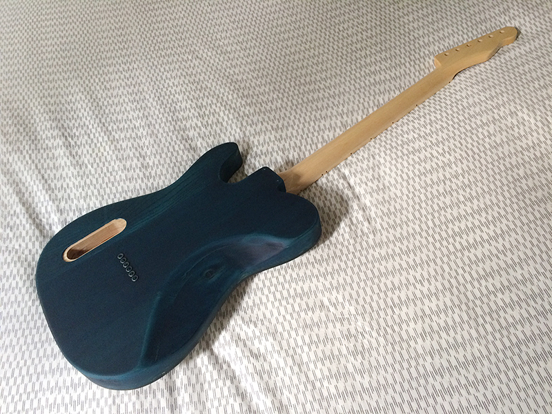

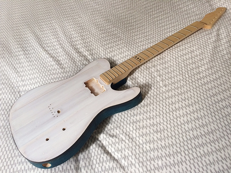

Working on this Telemaster right now. weed_killer made the body out of gym bleachers and scrap lumber. The neck is a custom order from USA Custom Guitar. The top is painted with thin coats of Minwax white tint stain base, and the back is stained with water based Speedball screen printing ink. And everything's getting coated with Birchwood Casey Tru Oil. (I liked the multiple plank vibe of the body, but wanted to tone it down a bit visually, so I did thin coats to let some of the grain and seams between the multiple pieces of wood still show through.)
Hardware and electronics are still TBD, but the pickup will be a Novak JM-180 (two P90s stacked on top of each other under a JM cover.)
