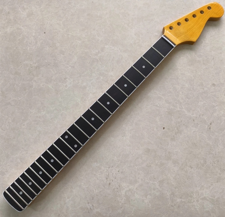

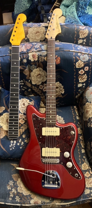

i was browsing on eBay and there’s several Chinese baritone conversion necks for $60-$90. it seemed obvious that the sensible approach is to order one and stick it on the Jazzmaster, so i snagged the cheapest one which was $80 with shipping. shouldn’t need much more than tuners and probably a fret leveling. that makes more sense to me than ordering a $300 neck before i know if it’s even comfortable to play. assuming that it’s useable, once i see if it’s comfortable i can decide where to go from there. i’ll order the tuners once i’ve seen the neck and decided whether it’s OK.

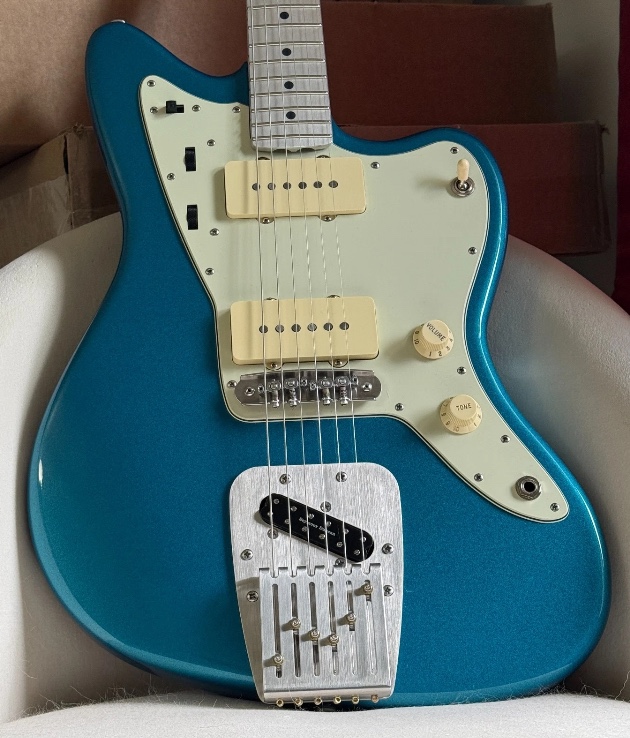

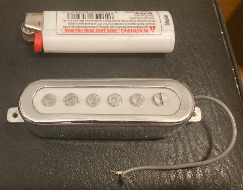

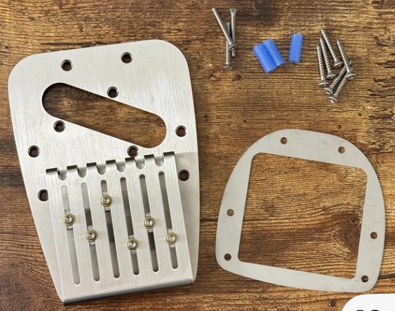

i might also try out this unusual tailpiece which i also spotted on eBay. it replaces a JM tremolo and is meant to extend the behind-the-bridge string length, make them tunable, and allow installation of a pickup. it’s made for a Tele bridge pickup, but with a little finagling it should accept one of the metal-shelled Japanese pickups i love so much. i already have an unusually snappy example (5.8kΩ instead of the typical 2.8-3.0Ω) i picked up specifically for this purpose; if i don’t do this on the baritone i’ll get another offset body, but it seems like the lower pitch and tension back there on a baritone would make a much nicer and more useable sound. i hate to give up the tremolo, though, especially on a baritone. i guess i could grab the headstock and give it a wiggle. it’s possible that it might lend itself more to a standard neck length and DADGAD tuning, though, which could make for a nice Irish harp effect tuned to the incidentals.
the Japanese pickup would probably go better with regular JM pickups than the Mojo WRHBs in metal JM shells i’ve considered, but i’ll have to think about that. it might be more sensible to get regular WRHBs which could go in other guitars with less weirdness. i’m trying to make it so stuff won’t go to waste if i sour on the baritone.

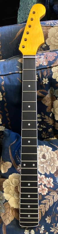

the baritone neck arrived yesterday, way ahead of the predicted delivery time. it’s better than i expected…on cursory examination there are no glaring flaws, the frets look quite decent, and the fingerboard binding is on point. the fretboard will need to be sanded because it’s fairly rough, but it’s better than the board on the Hopf which turned out beautifully. the finished parts also need to be polished out, which is a bit grueling but simple and par for the course. it’s startlingly light for a maple neck which might mean a different subspecies, but that’s actually a good thing because it won’t be neck-heavy. so far, so good. i’ll report back after i get the tuners and mount the neck. $60 eBay neck FTW.
for now my plan is to get a loaded JM body and alter the electronics, unless one of the offset bodies my friend Charlie is supposed to give me is in reasonable shape. in that case i’ll cut straight to CuNiFe WRHBs, which may be the most annoying pickups to type into a phone but are the sound i really want. so we’re moving along literally 6 months to a year ahead of schedule. woop woop.

on closer examination the neck has its little issues. the finish is cracked at a couple of the tuner holes on the front and one on the back of the headstock, not so badly as to be a problem but too long to cover with beauty washers. it looks like they drilled the tuner holes after the neck was finished, with a tired drill bit. the fret ends are also a bit ragged. overall, it probably won’t be so much work as to have made the $325 Musikraft neck less dear in comparison, but i certainly would prefer not to deal with e.g. sanding yet another fretboard. it’s better than the example in the ad, though, which was visibly slightly ripply on the face of the headstock. i have other fish to fry before getting into the neck, but inevitably it’ll be on the bench soon. anyway, i knew the job was dangerous when i took it.
