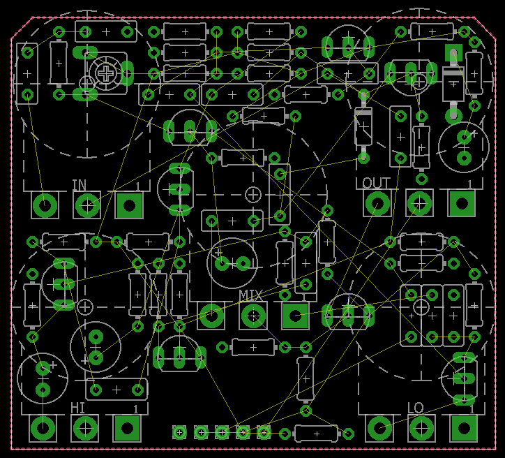

moved stuff around a few times. I still need to arrange all the labels. this fits inside a 125B.

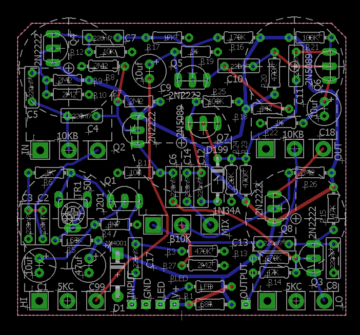

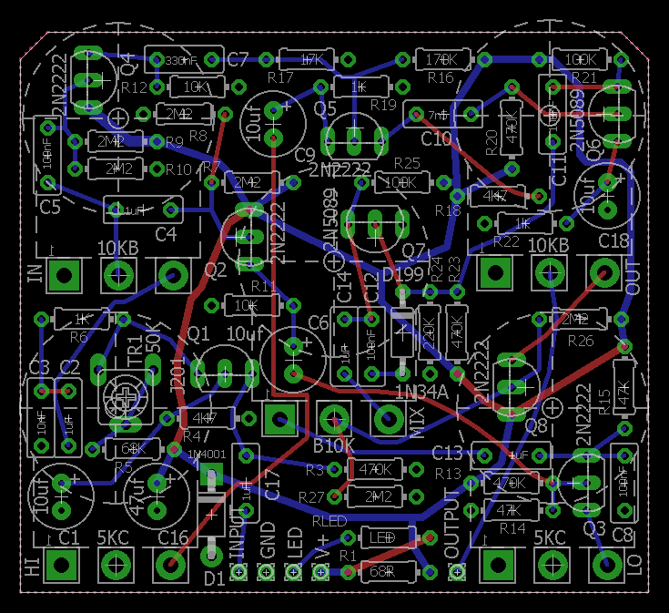

all the pots were on the wrong side of the PCB. so I had to rip stuff up and redo it. I placed all the labels. now I need to finish doing measurements of cap values so I can get this thing shipping ASAP. sorry to keep you waiting.

Imjonwayne I see C5 listed twice on the annotated PCB you sent me. Can you check again? One is ceramic 930nF the other is 98nF. Near Q7 C5 near Q4 C5. Im away from my computer at the moment. I haven't looked at the schematic yet. It is probably something really obvious but I wanted to get your thoughts on it.
- imJonWain
- Posts: 1821
- Joined: Sun Apr 27, 2014 8:56 pm
- Location: AVl, NC
Re: INFANEM the driving notion clone
Typo, sorry! Between C14 and C2/near Q7 should be C15 not C5.

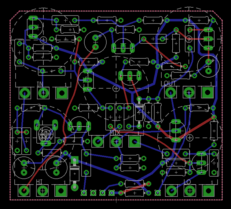

ok thanks. I will be ready to order the PCB pretty soon. I have to desolder C8 now. the meter does not want to do C8 in circuit.
