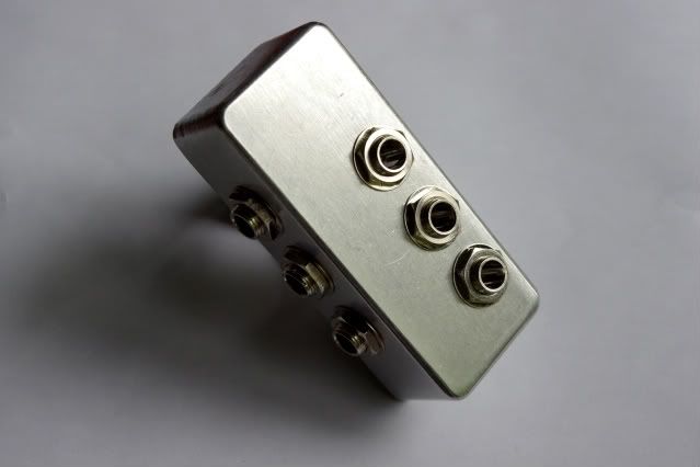

A simple mono jack feed thru box

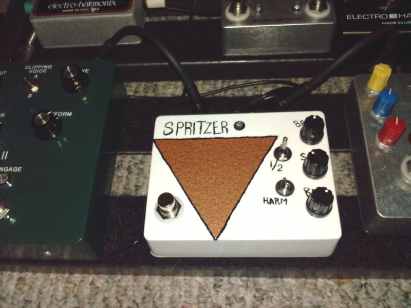

I made this for NDominy a couple weeks ago. I think you can figure out what it is ;)
The triangle is "hammered" if you couldn't tell. Pulled the name "Spritzer" from an old Maestro ad...
To be honest, I didn't want to send that pedal off when I got it finished. Might be my favorite build so far.

Jero wrote:I made this for NDominy a couple weeks ago. I think you can figure out what it is ;)
Awesome! I built one of those last week and gave it to a friend. It's sounded fucking awesome, though. Thank god I ordered two of those boards!
LaoWiz wrote:Awesome! I built one of those last week and gave it to a friend. It's sounded fucking awesome, though. Thank god I ordered two of those boards!
Thanks! Yea, I totally :facepalm: 'ed when it was done and I didn't have one for myself. It was a doozy measuring out everything for that space. When I build myself one, I'll likely make the "harm" toggle a stomp switch instead.

Jero - Looks great, where did you get the board?

some kind of small transformer in there?

Jero wrote: When I build myself one, I'll likely make the "harm" toggle a stomp switch instead.
Shit, might as well. Didn't know it was a 3PDT.

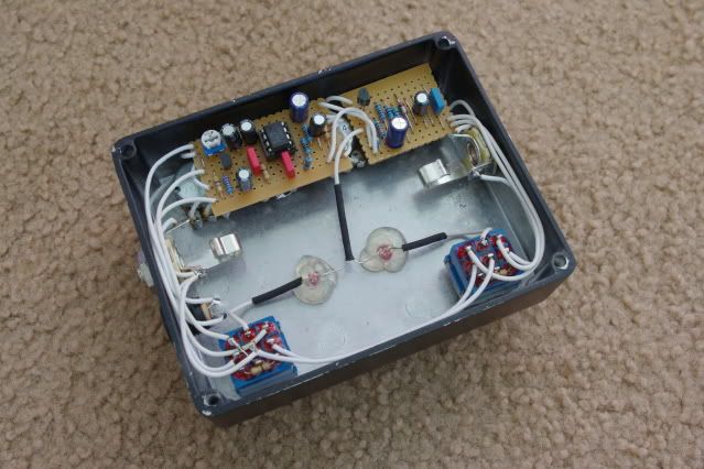

Yea I made one for my neighbor hoping he would use it tonight when his band opens for Sleep. It would have been great to hear something I made being amplified in such a huge space on a good sound system but I guess the Brassmaster doesn't fit in with the tone of their band. I guess it would have been better for him if it had a tone control. But if I mod it with a tone control I'll probably have to add a boost recovery stage, as well... So, I might get it back but I have another board to build anyway. I'm gonna socket the trannies this time, though.
I did find something interesting with the build. I didn't have a 3pdt for the harmonic switch, so I wired up two DPDTs instead. When you flip them symmetrically it works as it's supposed to function. When you don't flip one of them you get a different tone that's another shade. A great pedal!
StupidDream88 wrote:Jero - Looks great, where did you get the board?
15 bucks at general guitar gadgets
eatyourguitar wrote:some kind of small transformer in there?
Yes sir, that's where it's character comes from I believe
So, this is a little embarrassing, but I just realized I mislabeled the toggle switches. Feel kind of stupid, but the 3pdt is required for the 1/2 brass tones, and the spst is the harmonic.
LaoWiz wrote:Yea I made one for my neighbor hoping he would use it tonight when his band opens for Sleep. It would have been great to hear something I made being amplified in such a huge space on a good sound system but I guess the Brassmaster doesn't fit in with the tone of their band. I guess it would have been better for him if it had a tone control. But if I mod it with a tone control I'll probably have to add a boost recovery stage, as well... So, I might get it back but I have another board to build anyway. I'm gonna socket the trannies this time, though.
Haha, yea I was trying to get that one off to Nate before he left for tour, believe it was a success, though I'm not sure if he's actually using it. Thanks for the tip with the switch, I added it to my notes already :thumb:

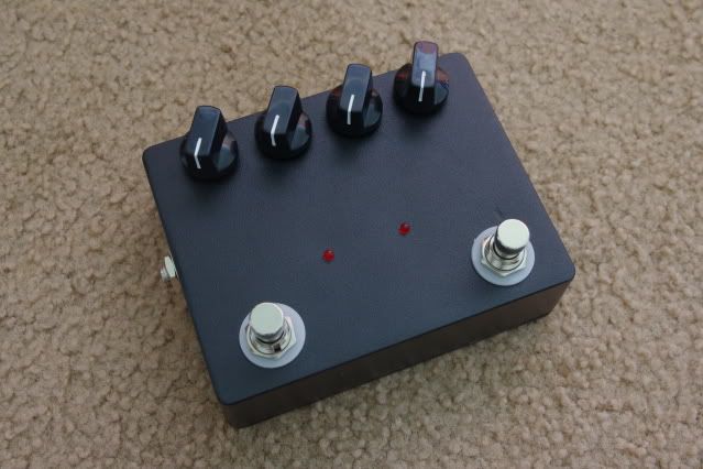

StupidDream88 wrote:Image
Sonic Titan > SHO
The ST makes for a great rhythm tone and the SHO is an awesome lead boost, not to mention how good it is by itself.
Headed to an ILF'er :animal:
Man, that's sleek! Your wiring is absolutely perfect. Is that solid core wire?
