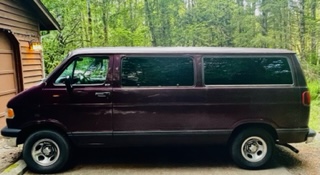

After a month and a half of waiting my doge van once again has a full pump! From what my mechanic was saying sounds like the last guys didn’t clean the sediment out correctly AND put the wrong size pump the last time I had to get this fixed.. It has a 35 gal tank not a 20…

Blackened Soul
Posts: 4783
Re: The Automotive (& other mechanized vehicles) thread
Post by Blackened Soul »
imJonWain wrote:#van life ?
For that kind of life you would have to stop the other life such as the moss growing in the carpet.. and you see, long ago in a distant time having a van and a band were one. :zen:
here is our purple Ramvan
