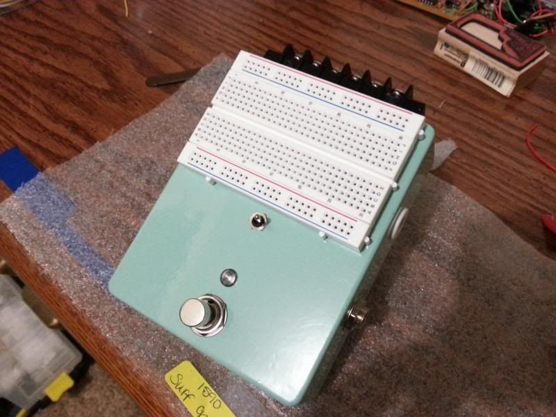

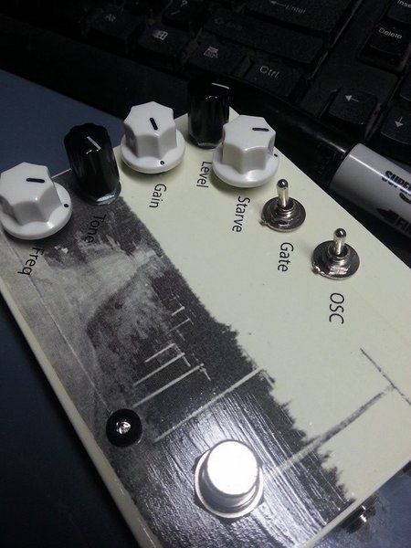

A clone of the EA Parallel Universe fuzz box. Very much fun.
Nice build. Did mine on vero a while back, it's a staple on my board, but I had a problem with it recently when I enlarged my setup.
