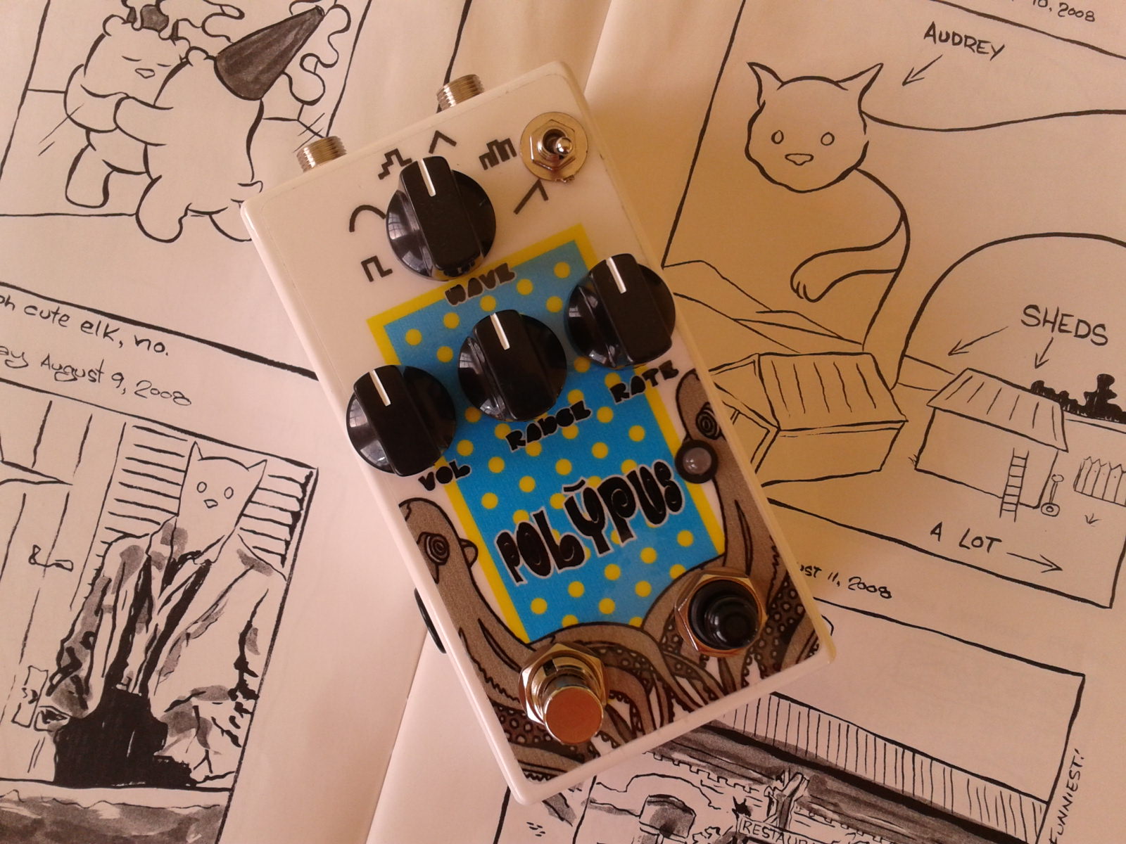

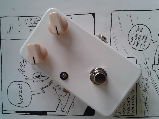

Postby autopilot » Fri Jun 01, 2012 9:45 pm
white polypus (ran out of green cases), the artwork was originally to be for the non-tap poly, but since i added the toggle, toggle up normal rate via the ratio, toggle down tap tempo mode

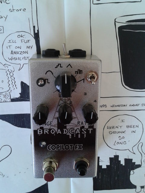

Postby autopilot » Mon Jun 04, 2012 10:40 pm
Custom Broadcast with 4 step sequencer. Right Footswitch selects from modulation (broadcast lfo) or manual (external expression). Left footswitch selects from sequencer or external controller (when there's no controller it goes from sequencer or reset to step 1). The sequencer controls the ratio of the tap or rate (depending on the toggle position)

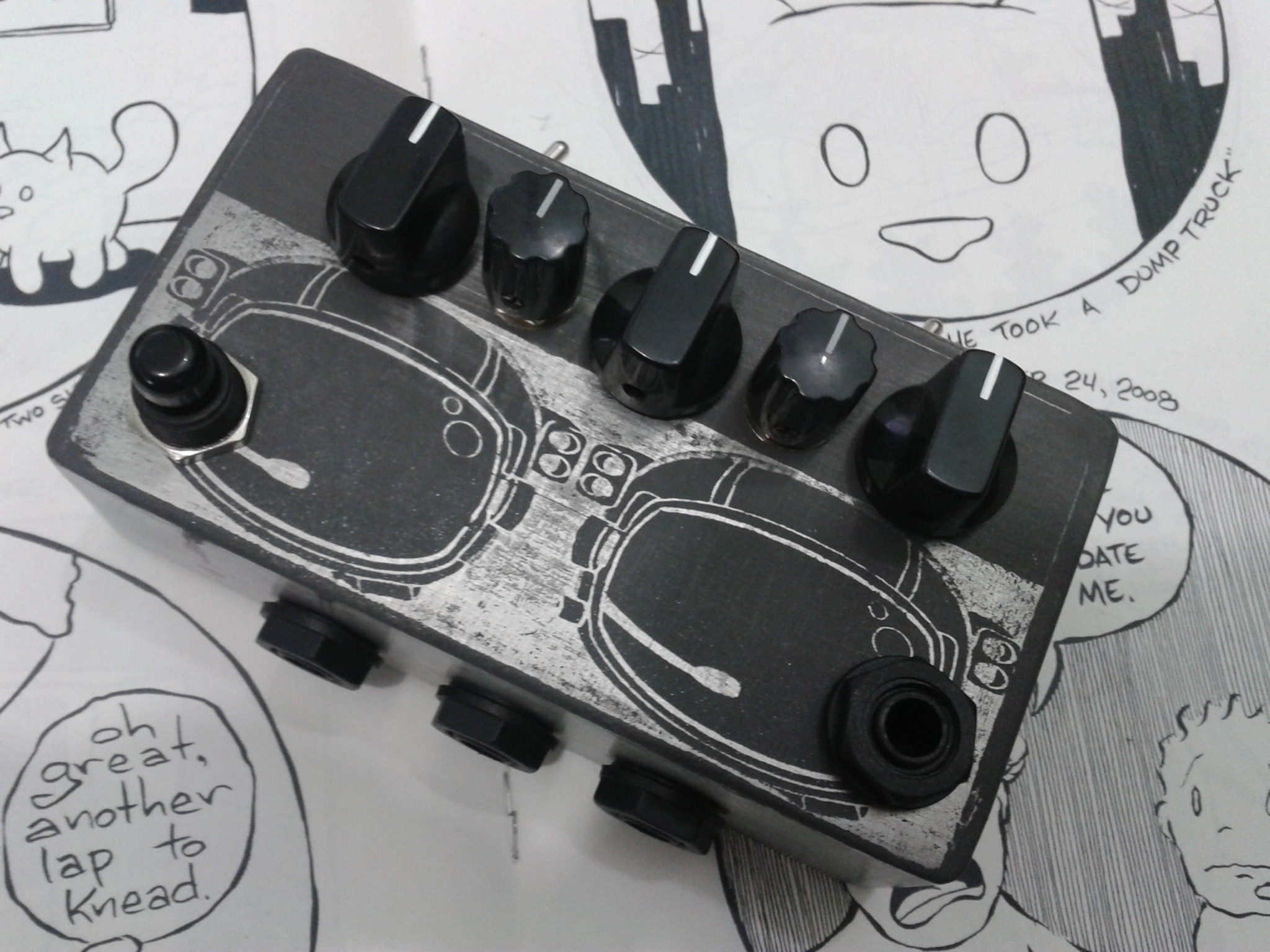

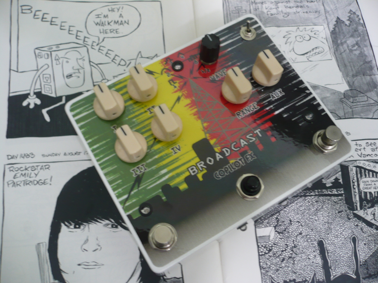

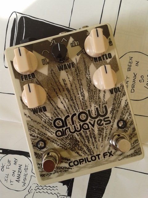

Postby autopilot » Sun Jun 10, 2012 1:27 am
Arrow Airwaves 2. Instead of tap tempo, the 2nd footswitch selects what the ratio does in LFO mode (led is on and flashes with the wave and rate that is currently being used) the ratio is the rate of the lfo that pans back and forth between instrument signal and wng. In the manual mode, the ratio blends both signal at 0 is full wng and going clockwise it adds more instrument signal and decreases the wng. The exp jack dissables the ratio knob which now (when the exp is plugged in) is controlled by the exp pedal.

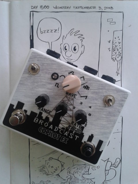

Postby autopilot » Sun Jun 10, 2012 1:44 am
Full Broadcast
jacks on top are expression in and broadcast out. The Footswitch select from broadcast modulated output or manual sweep (via expression pedal), when the pedal is on broadcast mode, the exp controls the ratio or rate (top toggle select which one), this option can be turned off via the toggle near the wave knob, so the ratio/rate will be set by the ratio knob.

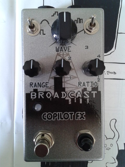

Postby autopilot » Sat Jun 16, 2012 8:09 pm
Another full broadcast , moved a bit the layout, both toggles are now upfront. And one single led that flashes with the rate and wave, it's red when its modulated or green when the output is controlled via the expression. When its modulated the ratio/rate can be controlled via the same expression or via the ratio knob

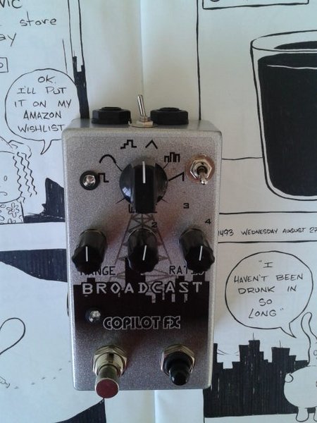

Postby autopilot » Wed Aug 15, 2012 8:29 pm
Broadcast:
-Dual Output Jacks
-Range/Amount can be controlled via exp jack (this option can be turned off via one toggle)
-Manual Sweep via exp jack

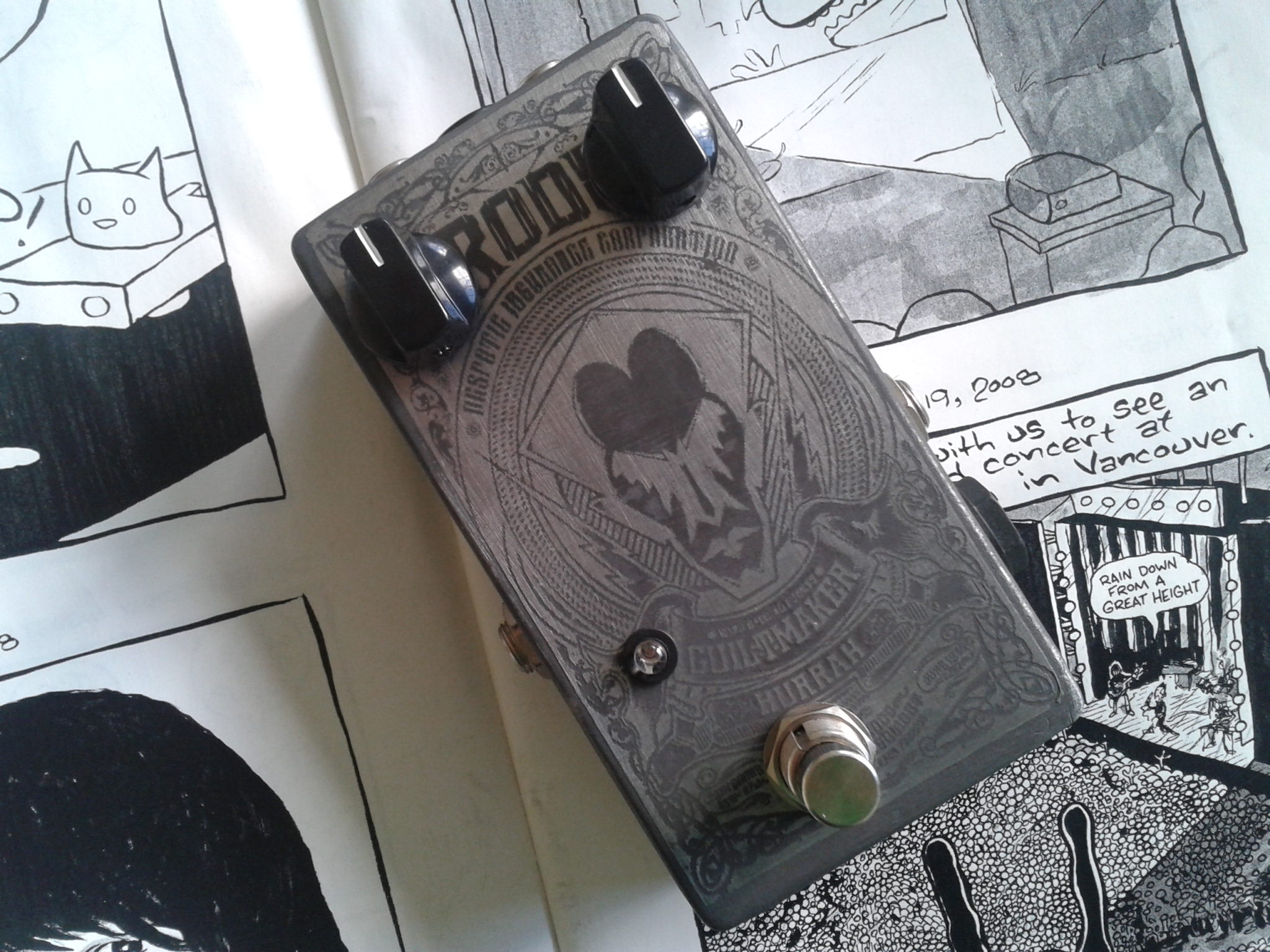

Postby autopilot » Mon Aug 20, 2012 11:00 pm
2 stage npn germaniun fuzz face-ish

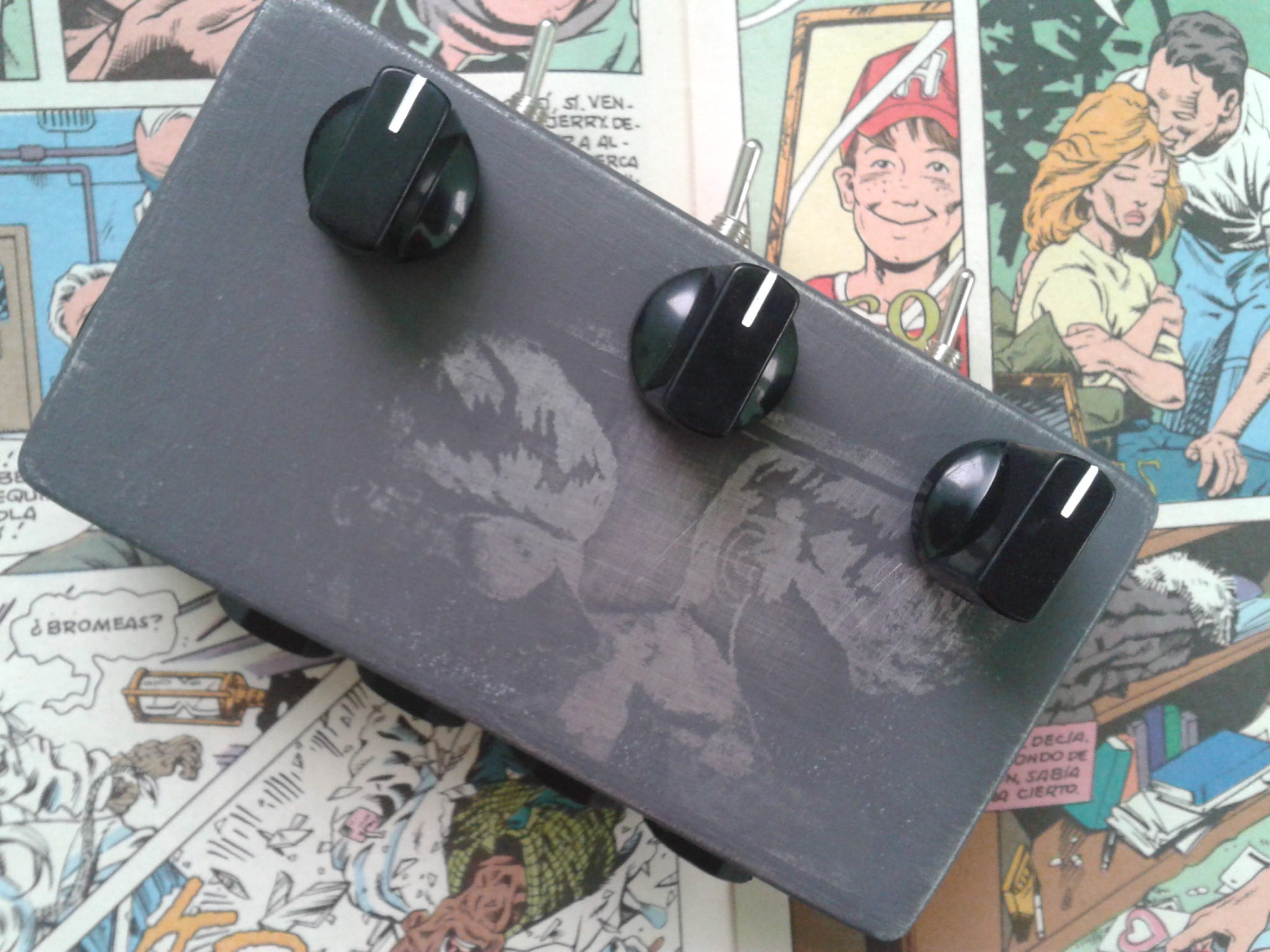

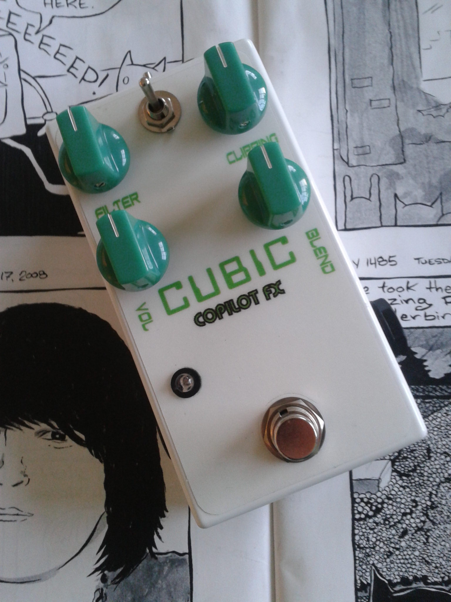

Postby autopilot » Thu Oct 04, 2012 9:06 pm
custom artwork cubic, less is more

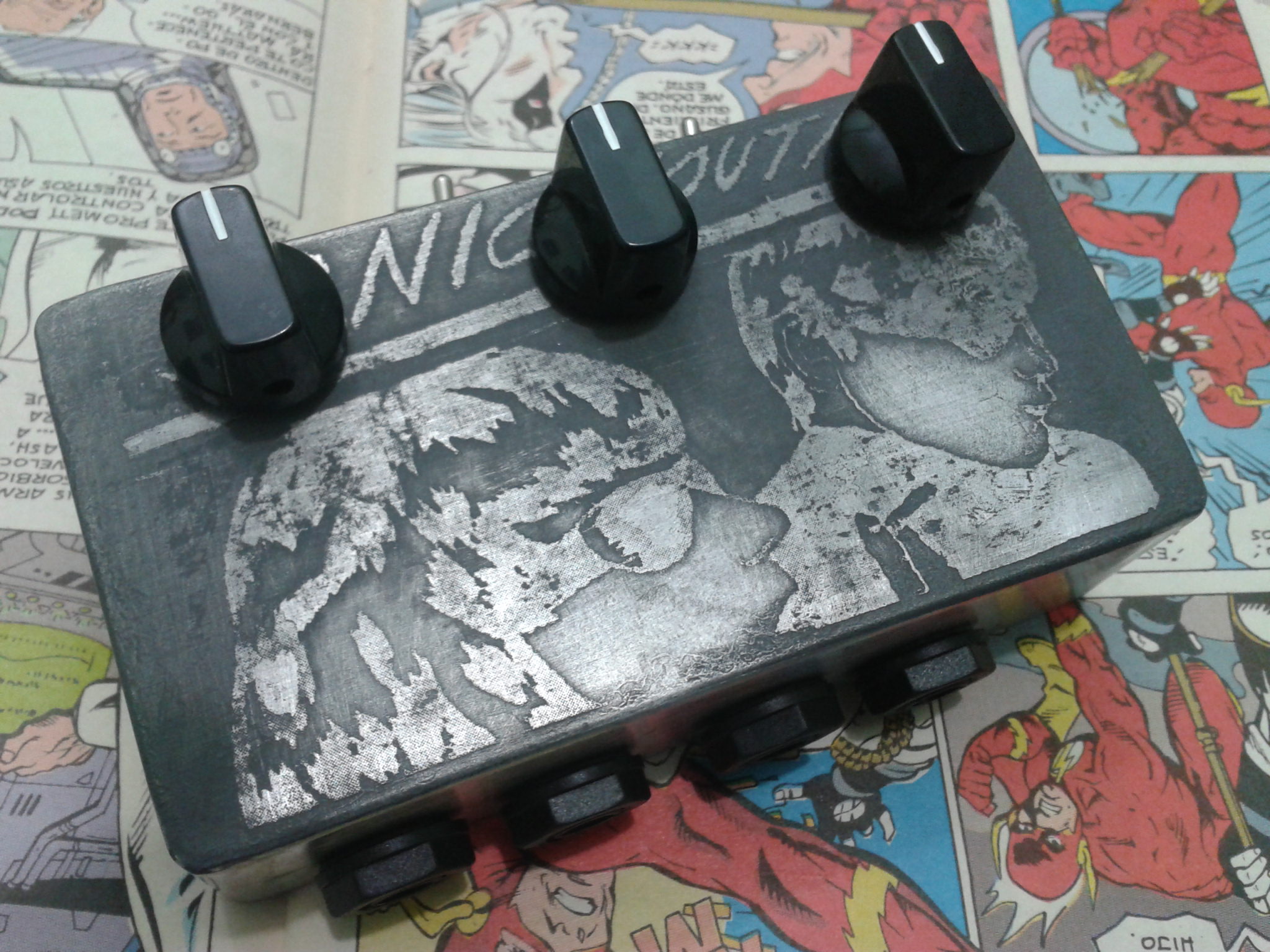

Postby autopilot » Sat Oct 06, 2012 8:17 pm
Expression splitter, it takes one expression pedal (trs type) or CV input and splits them into 3 independent outs, each out has a knob to set the amount of the sweep, so in one you can have a full sweep, in other a small sweep and other a medium sweep, or simple turn it to a fixed value (heel up or heel down). The toggles on the back are to set if at minimun the value is equal to heel up or heel down, or the direction if its a short sweep upwards or downwards, similar to the middle knob on the broadcast (for those who have used a broadcast).

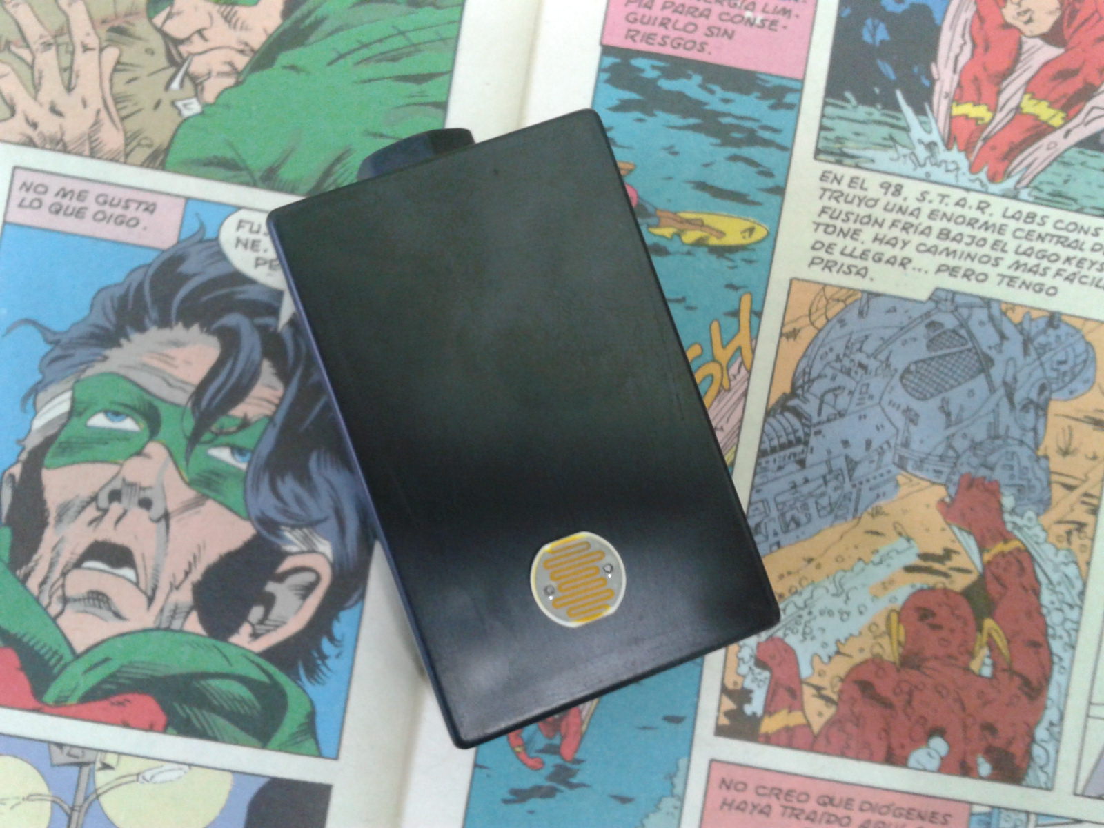

Postby autopilot » Wed Oct 31, 2012 10:11 pm
Pseudo Expression Pedal for a planetoid user. A photo resistor will adjust the value depending the amount of light (full light is similar to a heel down expression pedal). Just need to plug a normal cable and ready to rock.
