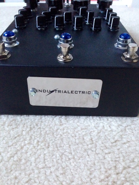

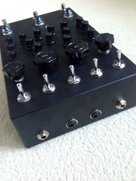

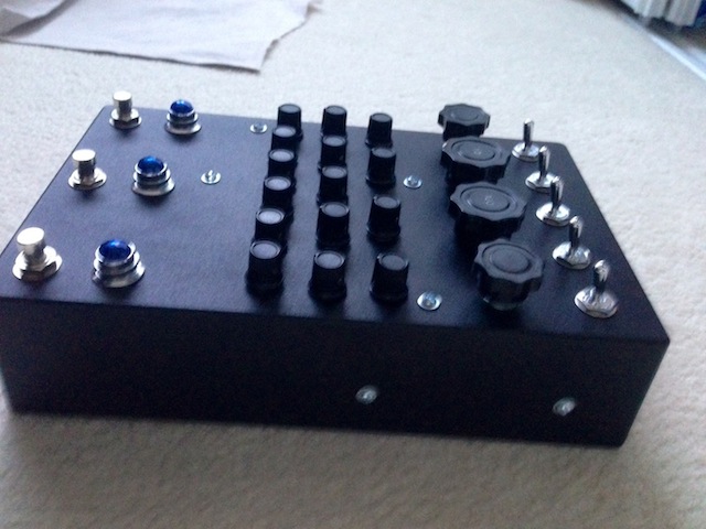

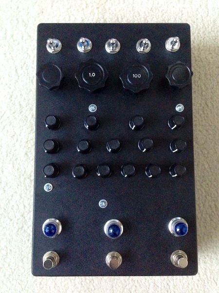

This took a long time but I finally finished my PLL monster
I recorded a little demo, it sucks but it's better than nothing lol This is just showing a little of the PLL side, I put extremely high quality components throughout and a few big mods on the original Schumann circuit and component changes. This can run in series or parallel with the fuzz just like the extra momentary footswitch but has it's own controls like gain, trigger, waveshape for the synth voices. I upgraded the loopspeed switch to a rotary to get from completely scrambled to a 20 minute siren! lol I managed to get it to have very tight and long sustaining harmonies and also be even more whacked out from the original. It's a serious noise generator as well!
In the V2 of the Schumann there was a CON switch which I found really didn't do much. When my friend Kevin at KO Amps traced the unit he found that it was a simple high frequency cut switch, a cap to ground so I toyed around with that and found that increasing this cap to a big amount gave it an extreme gate! which is really useful for short bursts of the synth voices! SO MUCH FUN!
It is the switch at the top left corner of my pedal.
I am going to be doing other demos of the fuzz side of this pedal because it is essentially the prototype to my upgraded Squarewave Generator pedal, sorry for the shitty sound and demo, enjoy!
[youtube]http://www.youtube.com/watch?v=eEKAB3IVlm4[/youtube]
