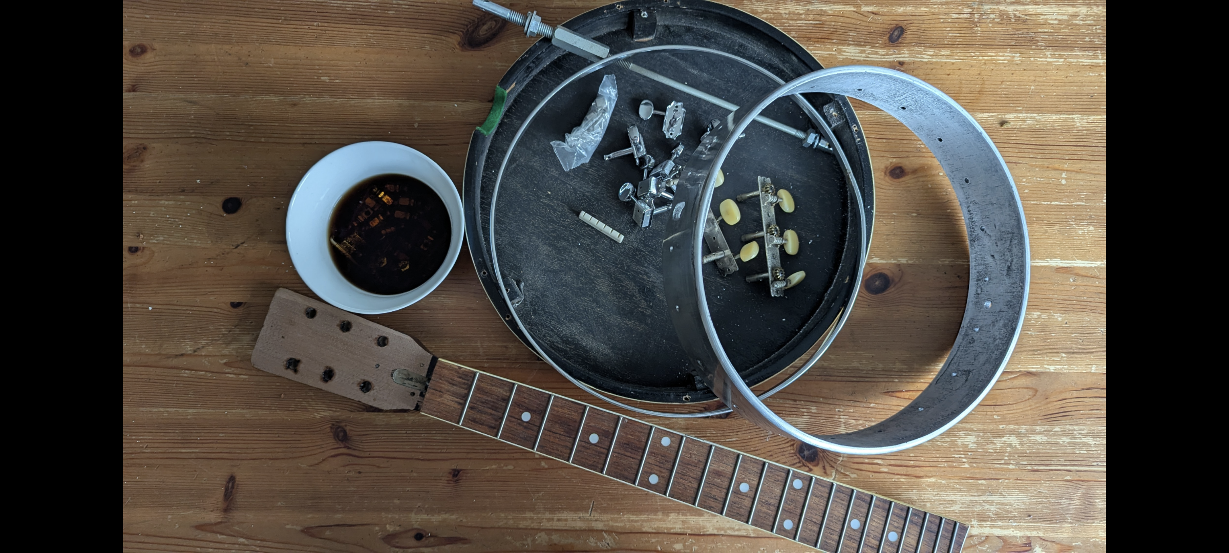

Okay, here's where we're at:
I dismantled everything and cleaned it roughly. The pot had paint smudged all over the inside and I sanded it off. I plan to polish the outside next. All the hooks and screws got a nice Coca-Cola bath to get rid of the rust. Today I expect the new head to come in. I guess I'll start to re-assemble the body this evening.
The neck needs a bit more work. There was an ugly butterfly thing glued to the front of the headstock and the solvent has damaged the laquer very badly, so I sanded it to bare wood. I ordered a sheet of creme mother of toilet seat material for acoustic guitar pickguards to cover the headstock. I always liked that look on old Stellas and recent Gretsch guitars and it would be quite fitting here. Maybe I'll just spray paint it black again, though. I first need to see it in person. The neck was attached to the coordinator rod with not one but two broken screws. Like someone just hammered another screw in after the first one broke off which apparently caused the second one to snap, too. It took me about an hour to get that mess out. I drilled a clean hole afterwards and will glue a dowel, then redrill and hope for the best. I already have a nice set of used tuners I found online for a good price. So slowly we're heading towards success.
