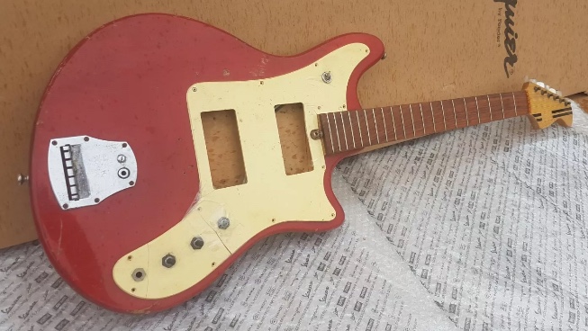

way off on a back corner of my mind is a second Hopf Twisty husk off eBay, complete except for the pickups, volume pot, and bridge. its pickguard is routed for large pickups; i've seen Twistys online with similar pickups. they appear to be PAF-sized with a kind of notched blade for a polepiece that has lower areas between the strings. i've seen exactly one of those pickups for sale used in the last 20 years.
assuming that it needs less help that my current Twisty, what in the heck would i do with it? the Hofner pickups are going in the Galaxiemaster, i'm not sure i like the Simeto single-coils from the Musima project enough to devote a guitar to them, and i already have multiple P-90 guitars so the Epi ones in the parts box would be irrelevant. i don't really know that i need another guitar in this format; if i was to do something with it it'd probably be in altered tunings because the 20-fret fingerboard is a real hindrance when you want to play higher than the guitar wants you to. i don't know how suitable it would be for any of the pickups i still want/need. maybe gold foils. the repro Davoli Wandre pickups Goldo sells to Eastwood for their Wandre Soloist are fantastic, but i have my eye on an Eastwood one which you never see used (because i guess either people love 'em or nobody buys them) so that'd be coals to Newcastle. this Twisty has been online for ages, so i feel no compunction to act on it.

for the record, this is the Hopf Twisty husk that’s been sitting on eBay forever. lead me not into etc. etc.
