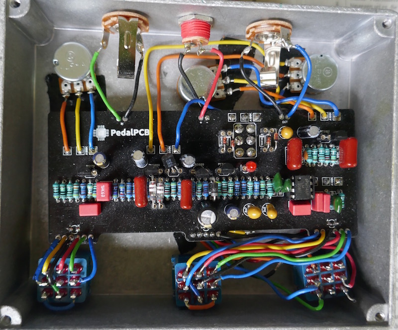

Here's the PedalPCB version of the EQD/Sun O))) Life Pedal.
I didn't like the knob and footswitch layout too much. So, everything got moved, except the clipping switch and the boost foot switch, which explains the spaghetti wiring in there.
Sounds pretty good.

Bad ass build
Agree the layout of the PCB isn’t great

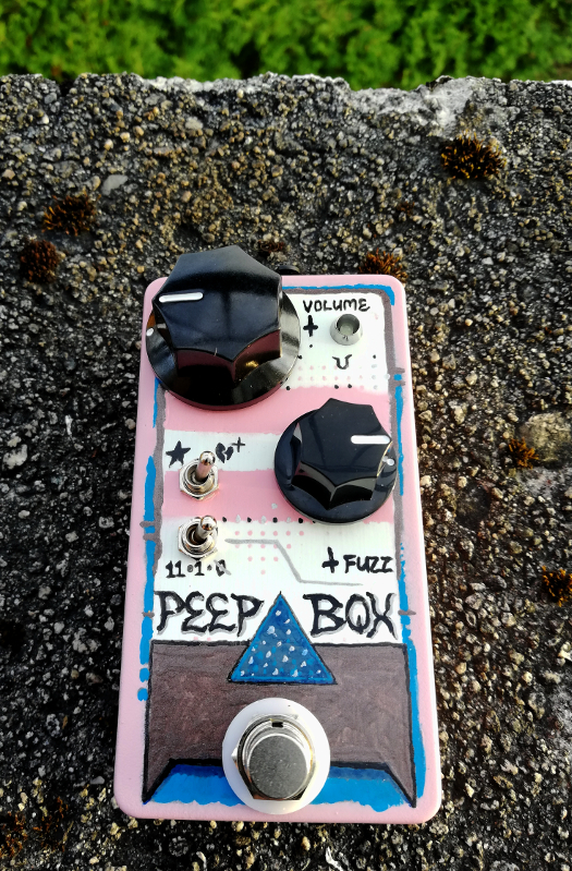

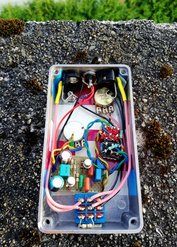

Here's something a bit more messy, though everything fits inside (just barely for the board on this one) and works.
This came about playing with the Basic Audio variant of the Pep Box on breadboard and listening to Lil Peep. Some resistor and cap adjustments, also put in two toggles in place of the tone pot; top is two-way bass boost (left)/cut (right), under that is a three-way mids switch that's heavy/flat/thin. Would have been more versatile with a pot but I wanted to try this and also have just two (big) knobs.
Sounds much like my previous Pep, still extremely loud but very controllable bias-wise from gated to open and over. Very responsive to different pickups/volume. Great bass fuzz.

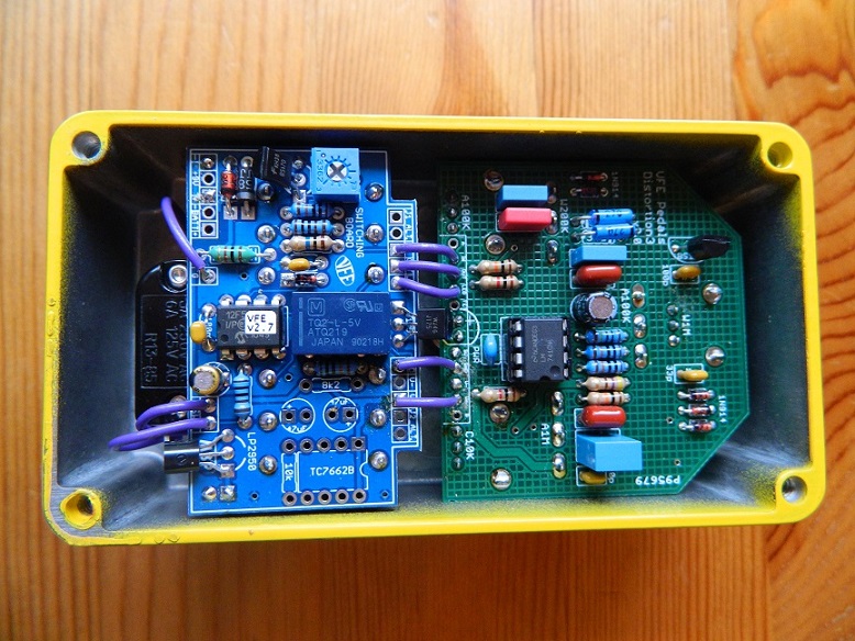

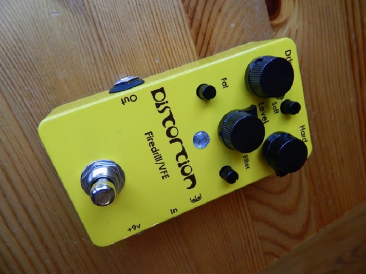

I've been liking the build reports here lately and have one of my own to share for the first time in ages. I got one of the VFE Distortion 3 boards from Madbean and am really glad to finally have a D+ or 250-type build that works well with my setup. I've had Rowland S. Howard on the brain since last year sometime, hence the MXR fixation; also, I hadn't realized that the 250 was an important part of Mudhoney's sound. I had a couple of goofs with the wiring and decal, but for the most part it went well. For the Ge diodes, I used some old mil-spec 1n270s I got from the electronics lab at the college where I work. They can withstand some significant lead-bending and soldering heat!

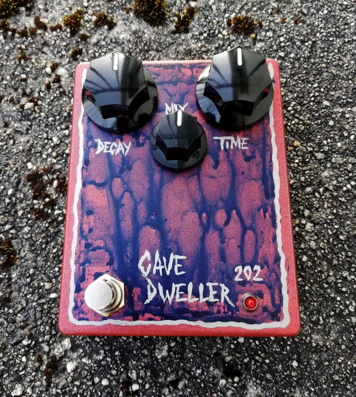

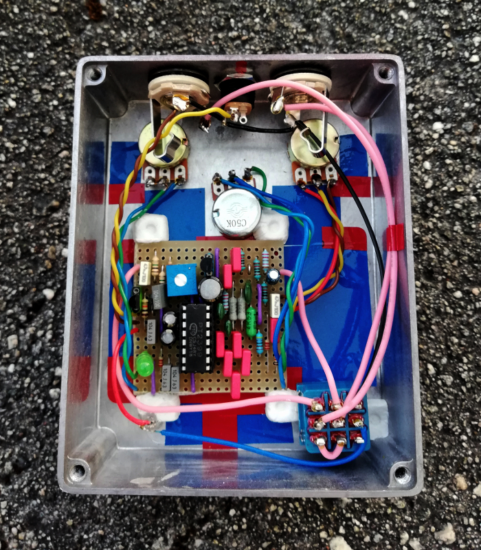

Here's a 2015 ed. Madbean Cave Dweller. Made the earlier version already, and while that's an alright delay i had to try the new one, and it does sound better. No tone suck due to the buffer, which is a J202. The long times past noon are still dirty af, but sometimes that's a nice thing. Has a bassless, airy sound that stays out of the way, and also coasts right on the edge of self-oscillation.
Forgot that I was gonna call every PT2399 build a sum-sum Delayer forever, but Cave Dweller is such a cool name anyway. The finish is red metallic rattlecan and ye olde Citadel Colour blue wash, I'll cry when that well runs dry.

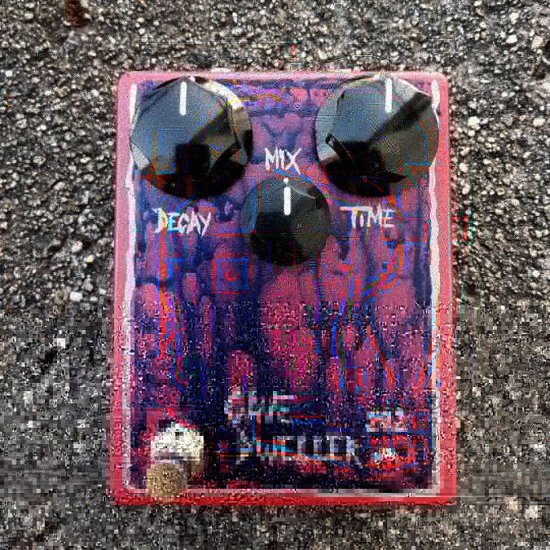

Bonus image: First actual corrupted image file I've gotten on my new phone, only editing is the gamma/contrast. This looks more like how it sounds.
