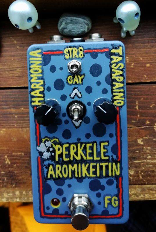

Postby frodog » Mon Aug 19, 2019 4:37 pm
Dude, very nice Datacorrupter!
Here's a Harmonic Percolator, my first actually. Had it on the breadboard first and tweaked a little, diode-wise mostly. Many good combos but went GAY, literally. Got a few of these NOS Ge beauties and yeah.. sounds good!
Asymmetrical configuration. Softer and quieter than the STR8 setting without diodes. This pedal is pretty smooth overall, nothing crazy in terms of gain but definitely loud, fuzzy and harmonik.
Up/down (or top/bottom) switch between the knobs was intended for a boost but that wasn't needed, so now it switches a feedback resistor, basically does nothing. Just adds to the already confusing Finnish layout.
Harmonia I think anyone can guess, and Tasapaino is the right word for balance in this context I thiiink.. Perkele - official swear of the Finns, and Aromikeitin - Percolator. Also a nod to their national flower, Convallaria majalis.
