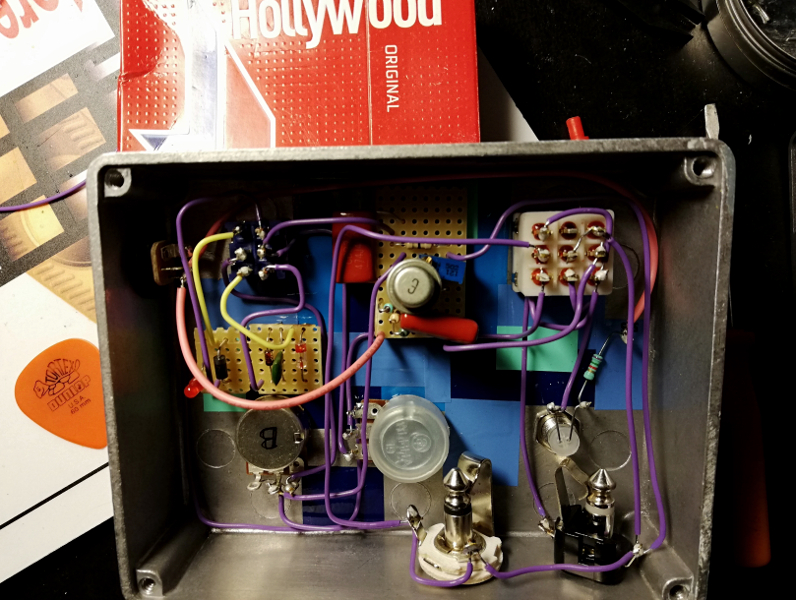

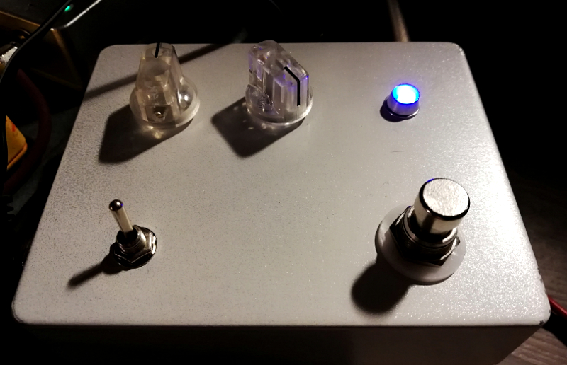

I interrupt your regular programming with another salvaged project. This enclosure I carelessfully drilled to house a Parasit U-235. Everything looked good until I pre-fitted the input jack, and of course it turned out to be right on the corner of the PCB, the plug would essentially hit a chip going in. So it seems that one will have to wait even longer to find a home. Another reason why I hate drilling boxes, even managed to drop this in the process but fuck it.
What I did then was put a Germanium Giant (https://tagboardeffects.blogspot.com/20 ... giant.html) in there, since I had it on the breadboard and it would utilize all the already drilled holes. Simple and very nice sounding, especially when pushed. Old MP38 transistor, 470nf caps, switch to select clipping between red LED/1N5817 and 1N34A/914 + 2.2 nf cap. Gotta swap out the power input, it's a bit unstable.
