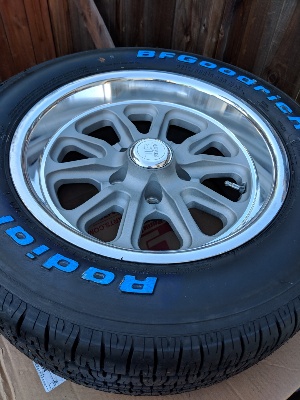

Been busy on the mustang. I'll do a crazy long write up about some dynamic compression and math stuff some day. I'm converting the Ford 200 over to Toyota Supra 1jz-gte forged rods (they are longer) which will slightly lower my dynamic compression ratio and should let me go slightly higher on the static compression.

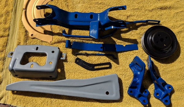

The suspension will be done soon...just got to finish grinding through filth and rust off the car and paint
Here are some random photos of paint and new wheels. (^like 1/2 of what I painted)
Some of these (those cast motor mounts) were rusting while I was grinding on them. I've never seen rust develop before my eyes....the cast iron would darken and start to rust within 30 minutes...it was crazy...grind and run to the rattle can haha.

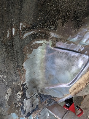

The dirty looking thing is the rear fender interior half grinded clean. I've got that one painted already...I'm gonna sawzall off the rear end tomorrow morning and get the ford 9" in there this weekend.
I changed the rubber bushings in the leaf springs to aluminum and hard plastic bearing/bushing hybrids. The front suspension has some of the rubber replaced with roller and needle bearings. I've got all new Bilstein shocks all around. New control arms, adjustable strut rods with heim joints, a new sway bar, Shelby gt coil springs...I'm also doing the shelby/arning drop. I'm also converting the steering over to v8 style.

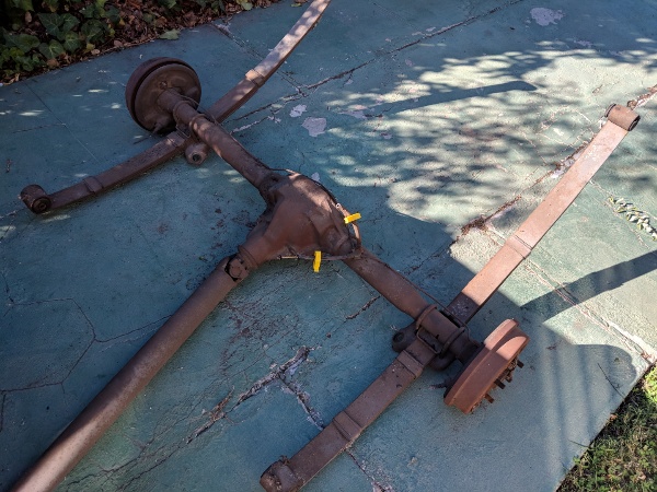

I got a Harbor frieght press to but in the rear bushings...and because I have to cut off the brand new bearings on my rear axle and push on new timkin style ones so I can fit the disc brakes off a Ford explorer (they need a spacer between the plate and bearing).
Painted the spindles (from a 67 mustang) and they look sharp. The front discs are off a 90s mustang GT.

Toothpick in an olive...look at that tiny ford 7.25".
Kinda fun driving the rear end around by spinning the drive shaft. I could kinda tank style steer it.
