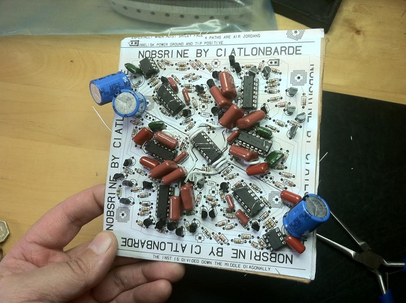

thanks, i'm a little confused by this whole Air Jordan wiring, for the most part it looks like its just connecting pins on the chips to one another on the top side.
On the other circuits there were symbols for jumpers where the wire ran above, looks like some of the Air Jordans make up those on this circuit too. but then there are those long Air Jordan lines that trail off towards the upper left side of the circuit board connecting to nothing, and another down to the right of the circuit board that just continues off the board not connecting to anything...I'm wondering if those need to connect to one another, somewhere on the back not shorting anything i assume? Only real instruction says the Instrument is divided down the middle diagonally...so I assume those AIr Jordan lines are connecting the two havles? but what do they attach to if not one another??? if anything? haha, looks like it will be about at least 6 or 7 hours of soldering before I get to that puzzle. :animal:

:lol: well, got one quadrant wired up....didn't realize I needed 10M resistors so might just wire some 2M in series to make do. here's a pretty interesting article Peter Blasser wrote that talks about the Nobsrine and how having a child influenced his design choices.

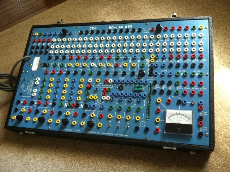

CES ed-lab 650

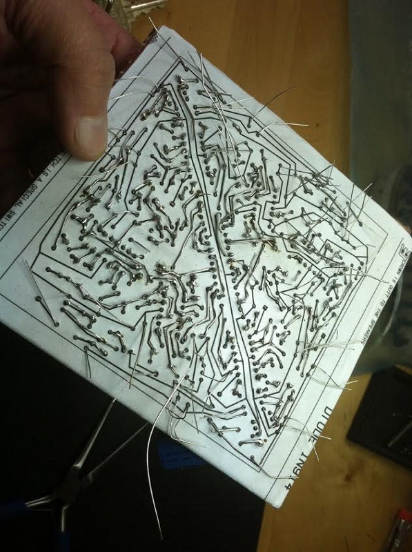

got all the major soldering done cept for those long runs which are always a real pain in the ass as you have to strip little sections here and there. need to pick up some 10M resistors and then I can finish the Ciat-Lonbarde Nobsrine paper circuit :joy: those Air Jordans weren't as tricky as I anticipated either. I've concluded those mysterious two lines going off the circuit board are just graphics??? unless I get to powering it up and nothing happens haha.

swoops triggering swoops would involve acquiring more swoops modules, sorta :excellent: once you run it through your oscilloscope you'll suss it all out, and he explains all this in his literature...but on a fundamental level one way to patch it, and it puts out its own triggers, is to just be triggering positive swoops. the other way is triggering negative going swoops. or you can patch it with itself to trigger a negative swoop after a positive swoop or vice-versa...which is cool and turns it into an oscillator. swoops is similar to one channel of a DUSG or maths, so you can do all that fun stuff with it and process other signals etc while also having his cool Bounds modulation and the range toggles! so obviously you need at least two, or more and then have them triggering one another into an intricate web of swoops. i've got five of em...and a maths and two DUSG. guess I really like this circuit haha, just so many functions you can get from it.
from what I could find ces sold those back in the 70s and early 80s to middle school or high schools etc. kinda like a fancy breadboard i guess. I was inspired to use it for patching signals from my ciat instruments through, probably send signals from the euro and my other modular gear through it too. even something like my Tocante touch synths I can send wires out from the little holes in their touch plates for each of the 24 oscillators and patch those through various resistors and capacitors and etc on the 650 to effect the sound each oscillator will make. also yeah, I've been researching into building Lunetta cmos synths so this could come in handy for that too. it has an input spot for chips, even one for experimenting with vacuum tubes. if all else fails i needed a bunch of banana jacks anyways haha.

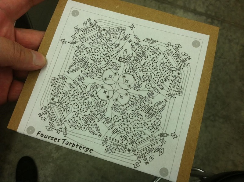

:lol: i'm still trying to up my patina game on the copper while staying away from using chemicals. i fired up the 650 and was surprised to find it had a built in speaker. was able to generate/mess with its three waveforms so I guess now I can add electrical engineer to my cv. thinking I should clean all the jacks but what little I was able to figure out so far worked :joy: now to keep an eye out for the logic lab. in the meantime tackling the ciat-lonbarde Fourses Tarpterge tonight. been putting if off for awhile cause its the most densely populated. Finally be able to play the Fourses/Intersexon/Fourses instrument though :yay: man...poking all those holes is a bitch.
