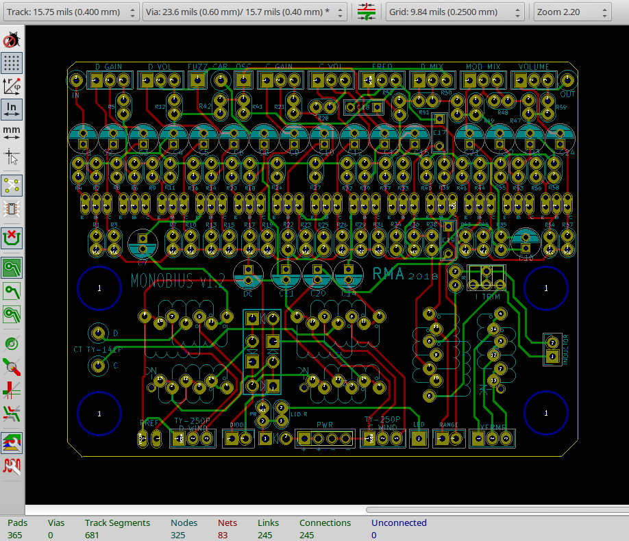

Postby crochambeau » Tue Oct 02, 2018 7:39 pm
The hoarder in you has my apologies!
I'm currently building up the very last Monobius PCB (allocated). Everything up to this point has been on a circuit board that supported some old transformers from 1974 (doing the inductor duty, the diode ring so far has been Triad TY-141P). Since I don't want to run out of old iron I spent some time yesterday redrawing the PCB to accommodate a selection of either the TY-141P or the TY-250P which boasts a dual secondary which may pave way to some things I'm not ready to reveal just yet.
I'm happy to reveal the circuit board though:
This of course means that these will not be available for build for a short bit.

Postby Dandolin » Tue Oct 02, 2018 9:38 pm
dual secondary :snax:

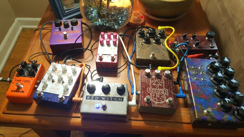

Postby BetterOffShred » Sat Sep 18, 2021 8:16 pm
Some good Saturday night RMA love here and some Fuzzhugger too .. Mudlark in the Upper loop for osc octave fuzz and currently running my monobius with a nice low mix ring that I like to juice with the delays visible and the mix with the ringworm with a sine wave on the carrier.. bangin devices Curtis I love them!

Postby crochambeau » Mon Sep 20, 2021 10:49 pm
BetterOffShred wrote:Some good Saturday night RMA love here and some Fuzzhugger too .. Mudlark in the Upper loop for osc octave fuzz and currently running my monobius with a nice low mix ring that I like to juice with the delays visible and the mix with the ringworm with a sine wave on the carrier.. bangin devices Curtis I love them!
That does look like a very nice table to spend some time at!
Thank you for the inclusion! :group:
