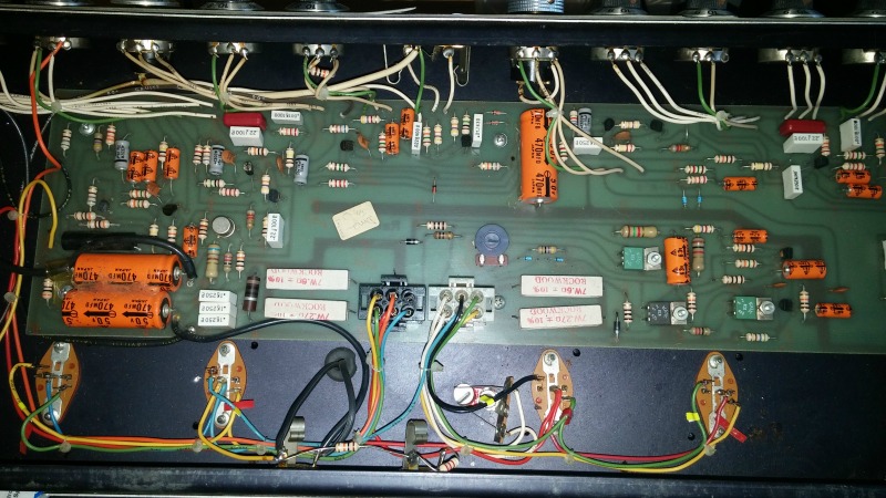

Upon inspection of the chassis I see a few obvious bulging/leaking electrolytic caps. I've compiled a list of all the electrolytics on the board. Should I go ahead and replace them all or just the obviously bad ones? They're more or less all the same Japanese made "SS" caps so I would assume they're all about at the end of their lives.

These guys are power supply filter capacitors? These are also electrolytic? Upon desoldering the leads and hooking up the DMM set to read capcitance, I receive a reading of OL on both of them after about 10-15 seconds no matter the orientation of my pos. and neg. leads. With minimal apparent PSU noise I will assume these are working properly and that I must just be testing them wrong.

Welp replaced all the electrolytics on the board and HUUUUGE improvement. Channel 2 is usable now, however, the HI input is not adding +6db as it should. There is no difference between HI +6db and LO 0db inputs.
Also, the reverb unit will start to feedback if it and the treble are turned up too high. Which isn't much of an issue since I like a pretty dark tone. I also keep my amp reverb down fairly low and use a pedal if I need massive verb. Plus I like having feedback on tap whenever I want it. =D
There is also a tiny bit of power supply hum that I must not have noticed before but that's not much of an issue and easily fixed. The circuit itself is SILENT though. Definitley going to be recapping a couple of the other orange stripe collection as they have quite a bit of noise/hiss/hum etc.
Now, to figure out this input issue...
