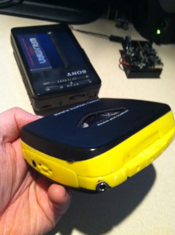

here's the walkman gieskes sent, i'm guessing the mod just attaches the wires from the motor...he mentions a certain type of walkman to use but that might have just been to do with how easy they were to open up and get at the board haha. that other walkman already has a dc input
