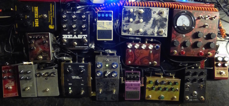

HR Moby DIck added, next step is the 1spot CS7 I bought today, I should have it on wednesday and will make it neater under the board.
Pedalboard project would be finished for 2015 but I have great ideas for 2016
that is NIIIICE. what kind of amp are you running it into?
