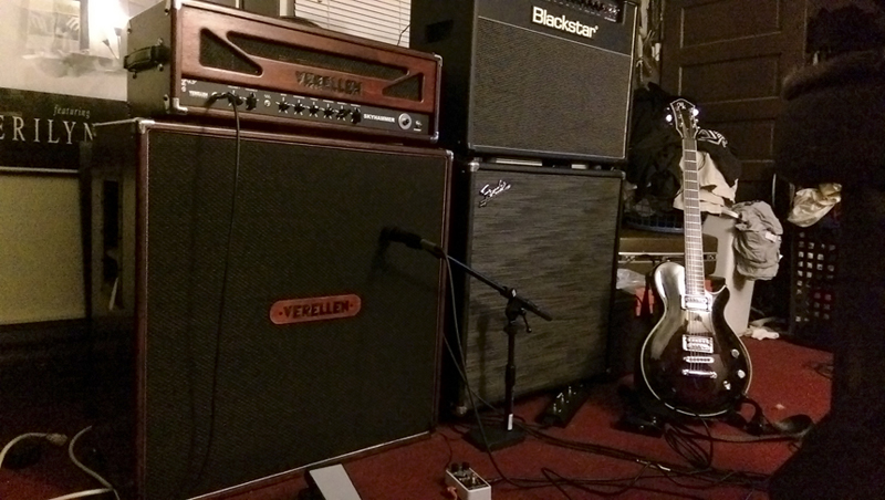

Here's a grainy cell pic. The Blackstar amp is like my backup amp. Sometimes I experiment playing through both at the same time. The Fender cab has V30s in it. I use that live when I don't want to take my Verellen. Depends on the venue really. If I'm playing some dirty dingy basement somewhere, I'm not taking the Verellen cab. Just not worth it. It's nicer than anything else I own, haha. It doesn't deserve the abuse.
Pedals in front of amp: EHX Pitchfork > Volume Pedal > Red Witch Fuzz God II
Pedals in the effects loop: Earthquaker Hoof > EHX SuperEgo > Boss R30 looper > EHX cathedral reverb
I get some interesting effects using both Fuzz pedals together. Feedback things...and the volume pedal can control the "wrath" function of the Red Witch Fuzz God nicely.
The guitar is a Michael Kelly Baritone. I really dig it. When I was looking for Baritones it won my attention.
I have two synths also going into the RC30 looper, but they're being routed to my mixer and then to the PA. They don't go to my amp at all. Depending on what I'm doing I have a sampler for extra sounds or drum tracks, and a recently got that horribly named drum machine pedal the "Beat Buddy". I haven't mastered that yet. Anything else I use goes straight into my mixer.
Pumped to get these 15s, Thanks for the feedback so far!

Sweet rig!

This is awesome dude! If the project in your sig is what this is for then even better because what I've listened to so far is cool as hell.
