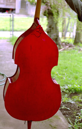

Here is the bass.
So here is my recipe plus a bit of chat.
I took Arnold's advise given on this forum and tried whaterlox colored with artist oils. Most of what I did was "based" on what Ken McKay posted in a thread on [url="http://www.mimf.com/"]MIMF.com[/url] called "What is your favorite varnish pigment or color for violins?"
This is what Ken said
And here is what I did.
Materials used:
Waterlox High Gloss
Naphtha
Gamblin Artist’s oil Colors
1. “ground” - "wash coat" = 25%-75% Waterlox to naphtha mix; a small amount of turmeric was added to the naphtha a day before mixing to add a bit of gold color. And yes I strained it!
2. Glaze #1: 60%-40% Waterlox to Naphtha mix with a added 8% of Gamblin Alizarin Crimson was added for color, This was applied by hand [my hand were red for days], clear coat of 75%-25% Waterlox to Naphtha mix was then applied
Bass was then let to sit for a few days then sanded to 250 grit.
3. Glaze#2: 60%-40% Waterlox to Naphtha mix with a added 8% of Gamblin Alizarin Crimson, 4% of Gamblin Chromatic Black and 5% Gamblin Alizarin Violet were added for color; this was applied by hand again but ONLY to the scroll, top and sides, clear coat of 75%-25% Waterlox to Naphtha mix was then applied
4. Glaze #3: 60%-40% Waterlox to Naphtha mix with a added 2% of Gamblin Alizarin Crimson, 8% of Gamblin Chromatic Black and 10% Gamblin Alizarin Violet were added for color; this was applied by hand again but ONLY to the scroll and top, clear coat of 75%-25% Waterlox to Naphtha mix was then applied.
5. 3 clear coats of 75%-25% Waterlox to Naphtha mix to whole bass.
6. The top wasn’t getting the look I wanted so I sanded it in places with 200 grit down to the Alizarin Crimson coat in places to give the bass a worn and old look.
7. 2 clear coats of 80%-20% Waterlox to Naphtha mix to the top.
8. Fine sanding to whole bass, grits: 200-300-400-600-800-rotten stone.
9. Because of the dark color of the top scratches were still visible so a final buffing with novus 2 fine scratch remover.

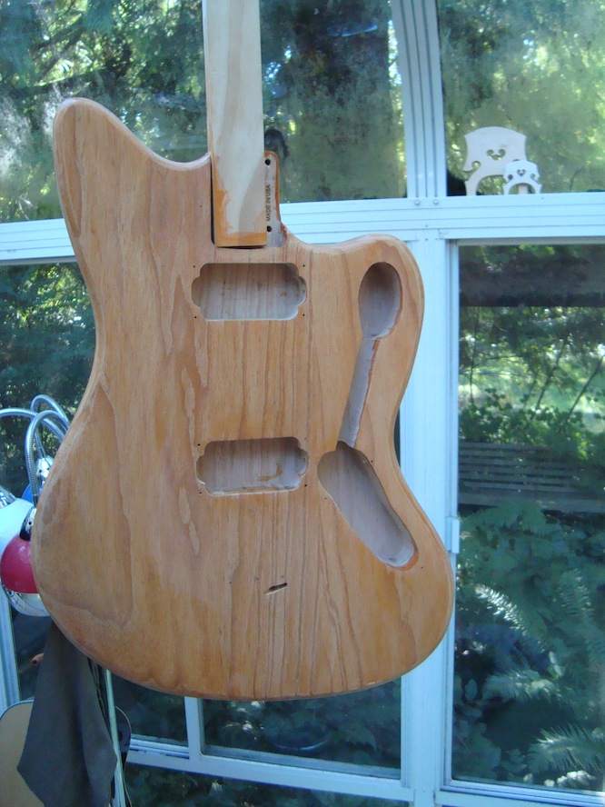

Note that I am changing some of the minor points from above which I wrote in 06. For this the first coat is undiluted because this is ash [and the grain will not be filled because I want to "feel" the grain texture a bit] and I wanted more "meat" on my first coat then on finely sanded plywood. Also I am not using turmeric or any other yellowing tint because again ash turns yellow anyway and this thing is going to be orange so I feel that would be redundant. Also also I am using Maimeri Classco oil paint on this because no one locally sells Gamblin. And a IMPORTANT point about this: you want a modern oil paint, meaning the smoothest you can find AND you need to make sure it has medium to low opacity otherwise it will be not cool.
So hereeeeee we haaaave my bass vi body
and here is coat one

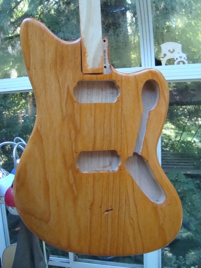

put a second coat on at the end of yesterday and sanded and did coat three a few minutes ago.

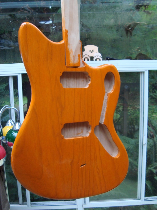

ok then.
Hand applied coat [yes my hands is now fucking orange]

I forgot to add the final project! :picard:
