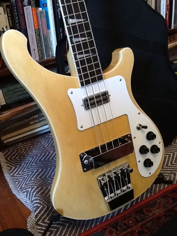

Post by ryan summit »
ive vented the story of this ric copy enough
lets just move on
and decide how to proceed
i stripped an explorer years ago
and it ended up being a sad disaster
ive done enough furniture by now
to know how to be gentle
but im worried about the binding
should i go chemicals or heat gun
would like to end up with a flat grainy finish
like aa's dirgemaster
viewtopic.php?f=188&t=2333&hilit=telemaster&start=4410
or just rattlcan over the existing finish
later on we can talk about
pickups,tuners,new electronics,etc
im not gonna jump on it right away
got a few things to finish up before i tear it down
thanks guys

I would probably use a heat gun or actually just go at it with a sander. If your going to stain it like my dirgemaster then you need to get through all the sealer and clear coat so you can get down to the actual wood. I'm afraid of how chemicals would act with the binding personally.

Heat gun or chemicals will damage the binding. If you are looking to keep it simple I would get an orbital sander and some sanding blocks for the edges of the neck.
Nice sanding blocks can be gotten at an auto paint sales place. Sanding will take longer but will end up nicer. I would absolutely stay away from chemical strippers as they can soak into the wood and then react with the new finish.
http://projectguitar.ibforums.com/ is a great resource for ideas and how to. Some very talented people there.

lets just say well enough
is a big yellow bass
that i aint gonna be able to sell
if indont make a plan
im gonna get pissed one day
and spray it in the bed of my truck
laying on bags of garbage
so heat gun the field
orbital sand the edges
then maybe throw it in a fire
everyone agrees no chemicals
good
i hate stripper
