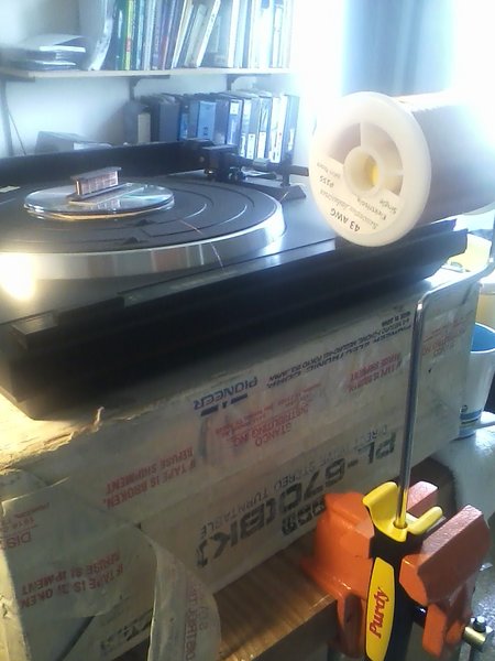

I originally intended to wind by time, using the constant rate of the turntable to put a certain number of winds on the coil per minute; you know, 33 or 45. At 45 rpm, it would take 2 hrs, 52 minutes, and 48 seconds. At 33 rpm, 3 hrs, 56 minutes, and 22 seconds. I found it difficult to keep the wire unspooling properly, without it forming kinks, or breaking, so I abandoned the timing method and turned the platter by hand, counting each full rotation. I moved my left hand back and forth spinning the platter and the spool (to let out more wire), guiding with my right hand. I counted to a hundred 78 times for each pickup. I tallied hundred counts on paper to keep track. I can wind at about 2000 winds per hour this way. Impractical commercially, but good enough for two pickups.
I've seen people on forums suggest setting the spool on the ground and letting the wire unspool from around the top, but I found that this twists the wire and causes kinks. I put the spool on a paint roller, but it was still too heavy to turn freely just by pulling on the wire, so I turned the spool by hand to let off wire a little at a time.
I found that it's easier to keep the wire feeding nicely if you dangle something on it to keep some tension. In my third picture you can see what I used, a little crumpled piece of paper.

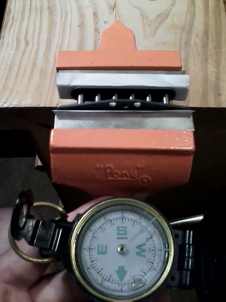

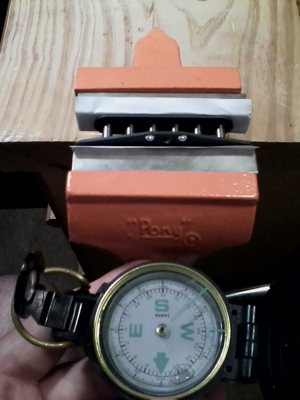

I used two 3"x1/2"x1/2" N42 Neodymium magnets from CMS magnetics set attracting each other in a small vise to magnetize the pickup pole pieces. The vise allows me to pull one magnet away from the bobbin and the other magnet without changing the direction of the magnetic field.

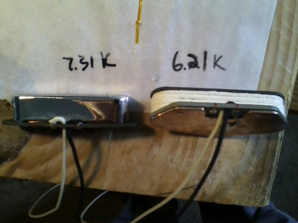

I soldered leads to my pickups today, and I noticed that one pole piece of the neck pickup is shorted to a winding. It seems that it's only shorted in one place, and the pole piece doesn't touch the pickup cover, so there shouldn't be any problem, unless the winding shorts to that same pole piece somewhere else, shorting out some winds. In that case, it should only be a few hundred winds at most, since only that many touch the pole piece directly. It would change the sound, but not unusably so, so I'd be fine with it, I think. I could always take it out and rewind it in the future if there's a problem.

I just put the cover on the neck pickup, but I wrapped the outside of the bridge pickup winds in a layer of polyimide tape, then with some kitchen string. The layer of polyimide tape underneath the wire winds of the bridge pickup did a good job, because no pole pieces shorted to any winds. This type of tape resists heat and is very thin, but doesn't really stretch, so it likes to crinkle up instead of lay perfectly flat, when you go around the ends of the bobbin.
I got the wire from Remington Industries, from their website. They sell on ebay, too, among a few other sellers. I bought the 1 lb spools, about 20-30 dollars each. About a quarter pound would be plenty for a pickup, though, if you want to buy less (and you see it available in lesser quantities). I do see smaller spools on ebay; just search something like, 42 awg magnet wire.
