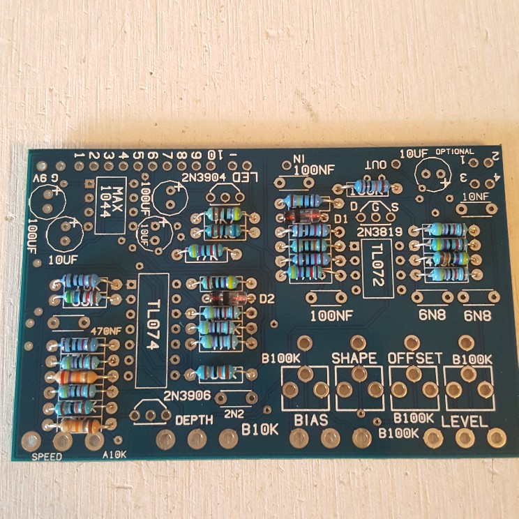

Postby BetterOffShred » Tue Sep 26, 2017 7:39 pm

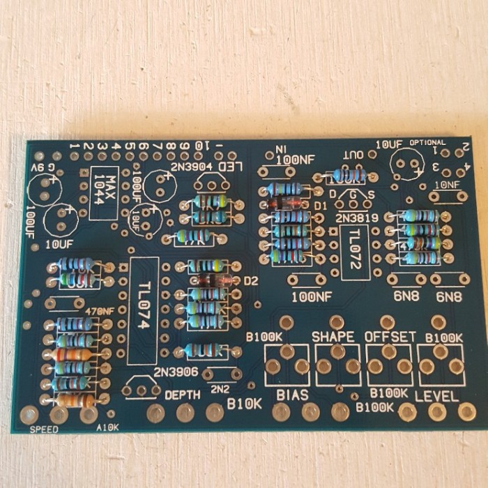

Done with all the resistors and diodes. The original called for 1N34A's.. and I luckily had 4 stashed. Booya! Having never soldered to a PCB I'm surprised how easy it is. My weller has a fine tip so it's going quick and neat, all that practice on crappy veroboard..

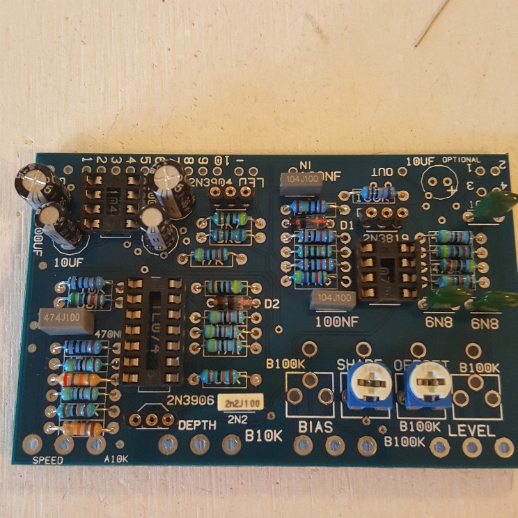

Postby BetterOffShred » Tue Sep 26, 2017 8:00 pm
Well the stuff that mounts to the board is done, so it's all offboard wiring now. I'm going to "squid" it up and try it out since I can't drill the box tonight anyway.

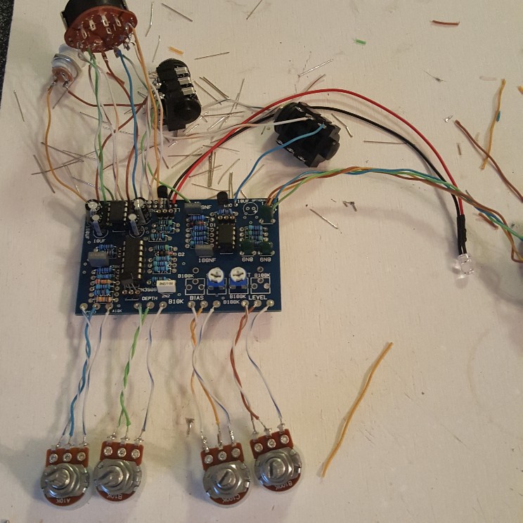

Postby LaoWiz » Tue Sep 26, 2017 8:42 pm
That's a great board. I've built it several times and was playing mine a few days ago. I remember on the first version I had, I hadn't followed the procedure in the build doc to set the trim pots. It still work fine but think the VCF settings were a bit off. But on the the VCA setting in one of the modes I wasn't getting any tremolo at all but just the greatest sounding distortion ever. Super fun pedal, mine gets ticking when bias is at max so worth doing that mod with the 10uf cap on a switch.

Postby BetterOffShred » Tue Sep 26, 2017 8:59 pm
Cool man! I'm definitely going to use shielded input and output cables inside as well possibly try a TL062 and LM324 if it ticks. It's also apparently a function of how well you have the trimmers set so I'll be exploring that too

Postby BetterOffShred » Tue Sep 26, 2017 9:31 pm
Well it works :joy:
It does tick, and I haven't been able to dial in the wave shapes. And I hooked the pots all up backwards... but it works!
So yeah some fine tuning now
