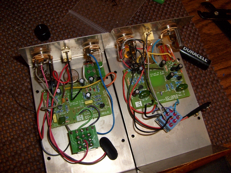

Here's the guts of the two different DMuffs I mentioned. Obvious thing you'll notice is the layout...then the use of 5088's vs bc550's...the switch pcb...I think the values are the same. The right one is mine, and it use to have another cap+res in between the black leads from switch and board.

Jero wrote:There were two versions of the original muff fuzz, as [Craiz] said, IC and transistor.
3 if you count the new SMD one with 2N5088. lots of people have posted the real [double muff] schematic but it always gets taken down. Aron Nelson said DIYstompboxes can't host the file after EHX asked him not to. all the strip layouts were on whack bullshit free image hosting sites long ago. all gone. I'm still waiting for the schematic. its not on FSB. its not too hard to guess those values even though its blurry.
I mentioned that one too :?: when I said they were re-released in the XO packages. I will draw a schematic for this in the next couple days, and send it to the interested persons. Not going to post it publicly though...gotta show a little respect right?

Did you see the picture I posted? That's where the schem would come from. There's no way I'm going to bother myself in tracing smd :lol: even though they would be the same thing.
