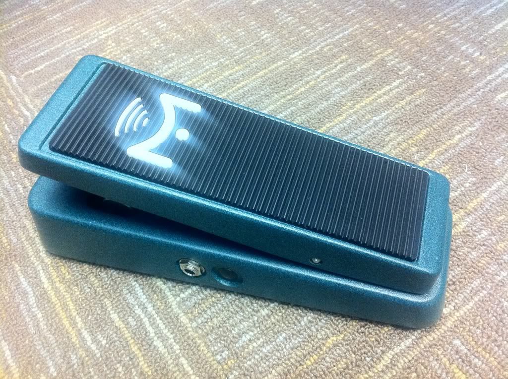

I just received the Mission EP-1. It should work similarly to the EP-2 and at least for my usage better. It actually has a 10k pot in it which my intended pedal actually prefers. I should get a more controllable sweep.
Also a pic.
