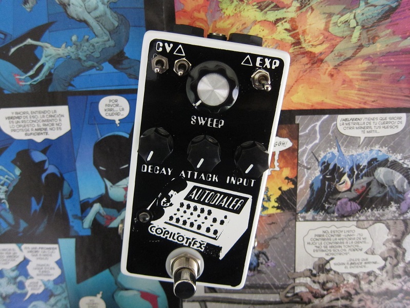

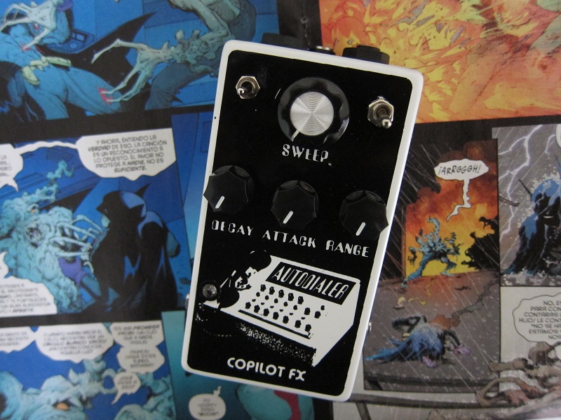

Autodialer
over the years I got some requests for this, so here is the autodialer, is a buffer, is an envelope generator with exp out and cv out and perhaps could be the telemarketer that always calls you at 7:57 am to chat with you and you should have talked about cthulhu. Will be available next month, since I might add a trigger mod, so via a footswitch you will also trigger the envelope, in case you are a dark soul that do not want to enter the funk and want nothing to do it with it. Price will be $115

Re: Autodialer
So is the envelope triggered by the input? Is there a sensitivity control?
- autopilot
- Posts: 1069
- Joined: Sat Nov 18, 2006 9:19 am
Re: Autodialer
yes, the range adjust the input sensitivity and the sweep knob the amount of output (trs 50k), at minimum it will "bypass" the envelope at toe down or heel up (depending on the left switch), since it is a buffer you can place it earlier on your chain or out of your chain if you want to trigger via samplers, other instruments
